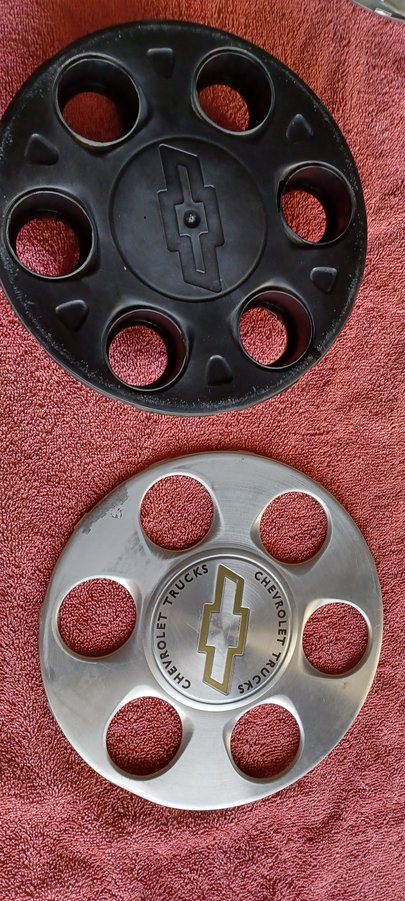

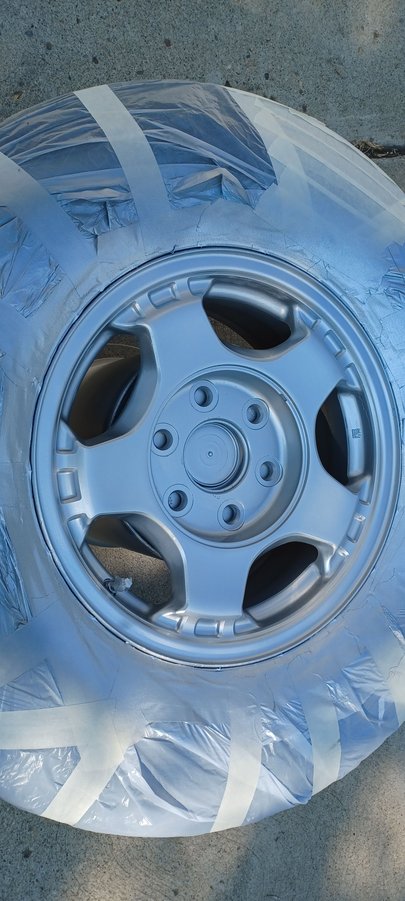

Wheels looking a little tired...got some time to refresh them. Roughed up the old coating, cleaned up the bad spots...
Center caps need attention. Sanded them as well. The face is held on with tabs, pretty sure its aluminum. The plastic lug nuts pop out from the back with a small screw driver...
Once sanded, a coat of epoxy primer...should help with adhesion.....
two coats of silver metallic base coat...two coats of clear....

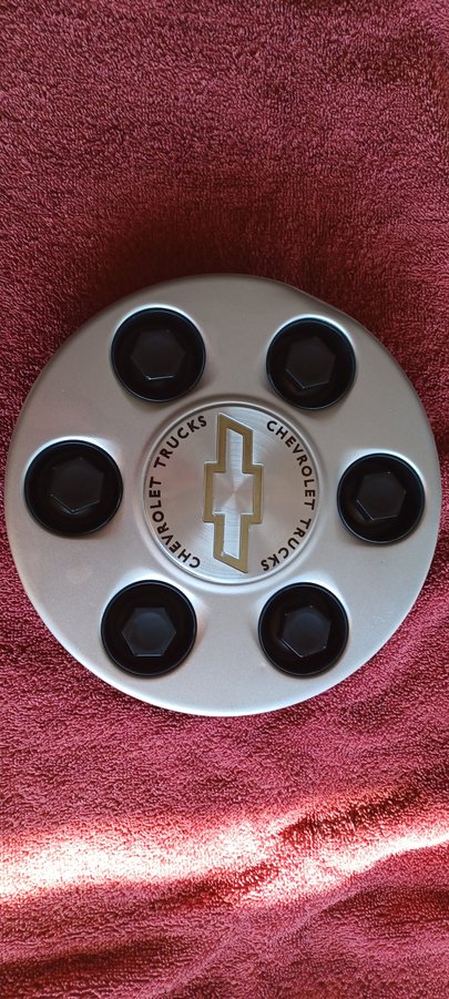

Instead of trying to spray the lugs, used a small brush to add trim black paint....
added a coat of adhesion promoter to the center caps, two coats of base, two coats of clear, they clean up nice...
done!!!

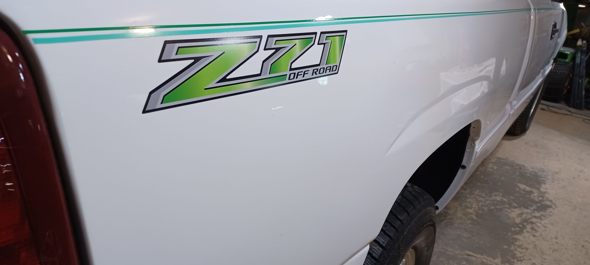

Wasn't happy with the army green emblems, pulled them off and did a florescent green repaint
matches better with the green pin stripe
This spring/summer gonna replace the exhaust system, should have done it when i had the box off...then the truck will be officially done.
