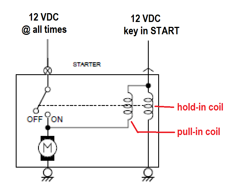

Here's why a bad starter is a good guess. The Tracker starter motor has two coils. The pull-in coil is required to engage the pinion drive lever
which simultaneously moves the internal switch from OFF to ON. The current path for the pull-in coil is through the starter motor --- the only
device that draws enough current to cause a heat related problem. If no pull-in current flows through the starter motor, the motor will not
turn. It won't even click.
If the pinion drive lever does engage, the internal switch places 12 VDC at the bottom of the pull-in coil. With the held key in the START
position there is also 12 VDC at the top of the pull-in coil. The difference in potential is zero so no more current flows through the pull-in
coil. At that point the hold-in coil is the only thing keeping the starter engaged (until the key is released).
If the brushes, commutator or windings are not passing current when hot, the starter will have to be repaired or replaced.
