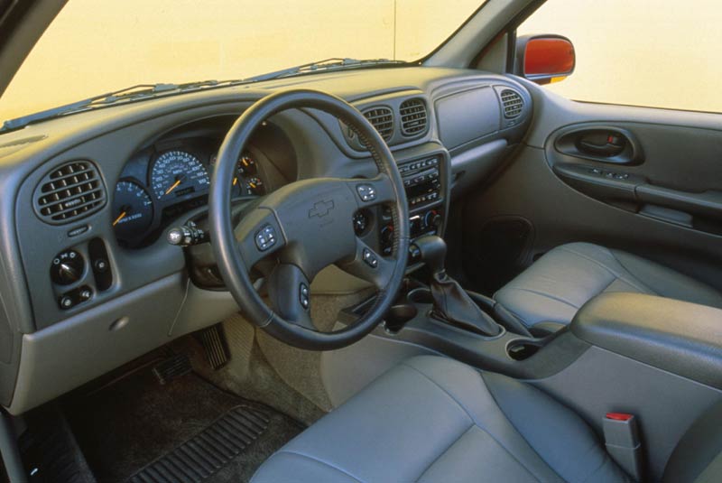

The indicator is triggered by an hourmeter and or the mileage, whichever comes first, usually every few hundred hours or few thousand miles( dont know the exact specifics on yours). My reset is on the steering wheel ( the back arrow button, hold for 3 sec.) it may be different on yours.

Originally Posted by shawnvw
To reset it after an oil change, turn the key on with the engine off, and fully depress the gas pedal 3 times in 5 seconds...the light will flash then turn off
Is there more than one way to reset it?
This is an 02 TB steering wheel.... same as mine

Old Apr 21, 2009 | 6:24 AM
Brian@work's Avatar
Joined: Apr 2009
Posts: 8
My steering wheel has no buttons on it so I'll try the pedal thing. Thanks for the help everyone.

Originally Posted by Brian@work
My steering wheel has no buttons.
That explains my confusion,
