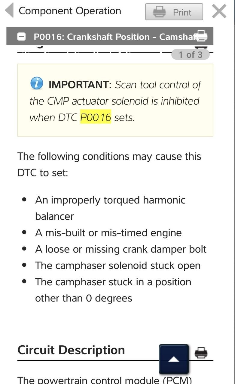

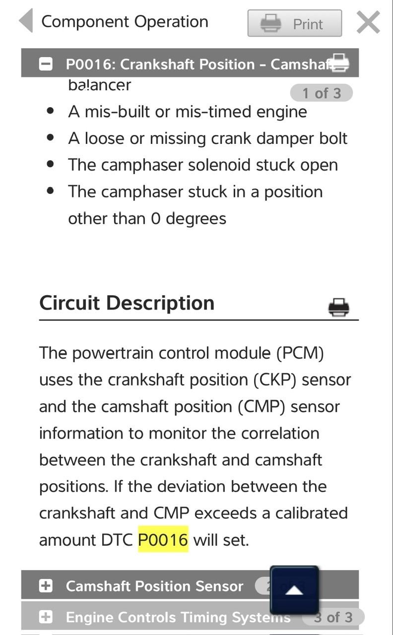

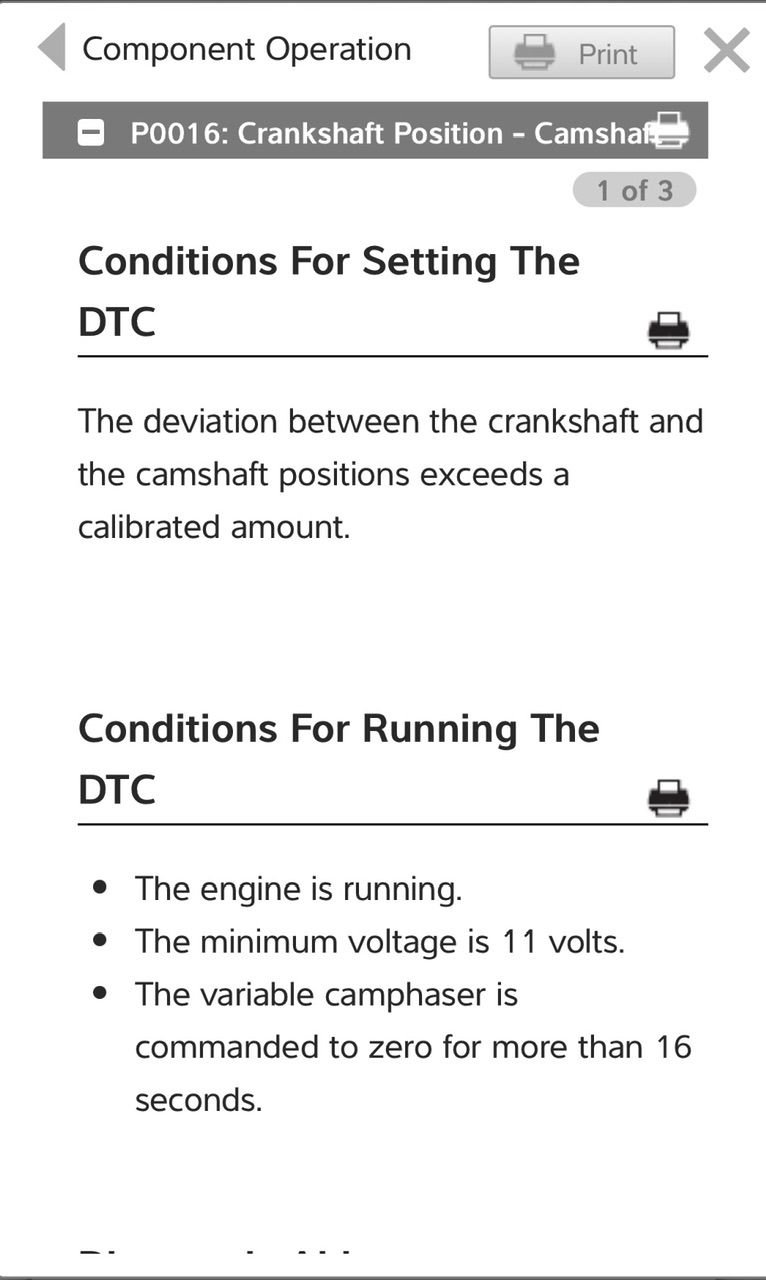

I think the most likely cause is the chain jumped a tooth, regardless of how it may have happened. If not a jumped chain, another mechanical cause, such as oil leaking past the control solenoid when it shouldn’t be.
These codes (Crank to cam correlation) are, generally speaking, dependable for knowing it’s a mechanical problem provided there’s no other codes set such as a cam or crank sensor performance/circuit code.
The quickest way to isolate the fault is by scoping the crank and cam patterns at the same time with a multi-channel scope. The overlay of the signals with the VVT disabled will tell you immediately if the cam and crank are synchronized.
I’ll do some more digging when I have time but here’s some screen shots of service information (tried to keep them in order )
