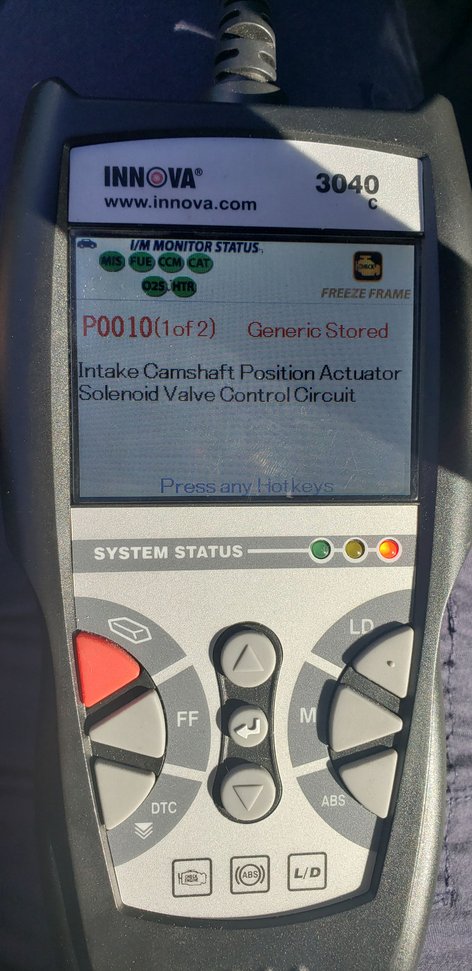

Hello guys! So I'm working on a 2008 Uplander. The uplander has a check engine light with code 0010. Vehicle shifts hard at times. The transmission fluid is good and all. Autozone said to check the Camshaft Position Sensor so I replaced that. So nothing has happened yet. Been trying to figure this out for a bit. Maybe some diagram and location would help. Thanks guys!

The p0010 code is engine related and not transmission. For example if your engine has sludge it can trigger that code. A short or open wire could cause that code to appear as well. It does not necessarily mean the sensor needs replacing though.

Thanks for the reply! I was reading that the PCS (Pressure Control Solenoid) might be the one to blame. I'm gonna replace that this week and see how it goes.
