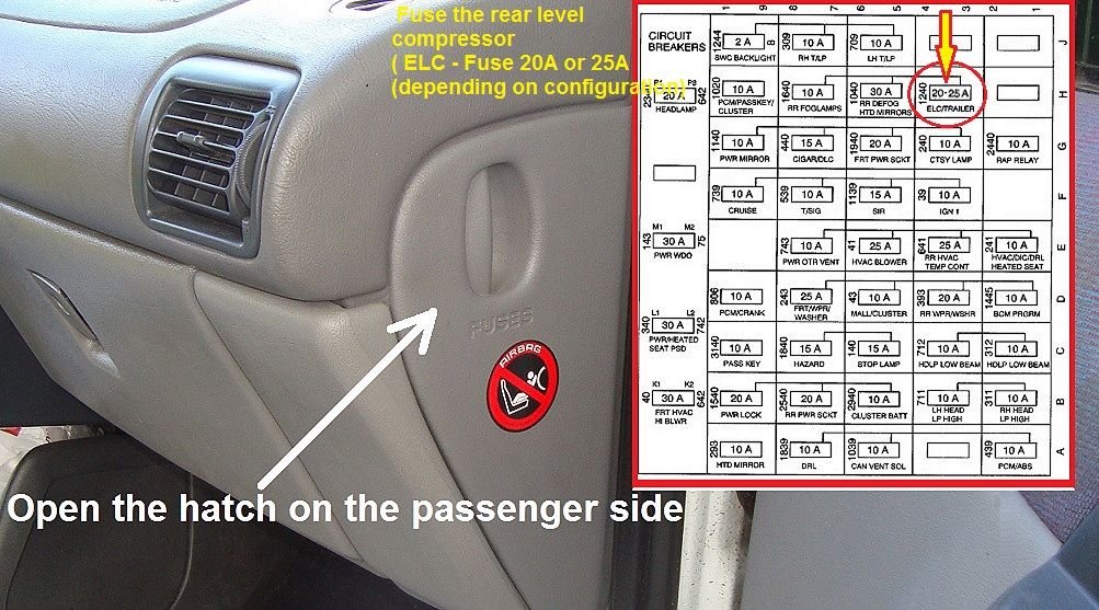

Can someone please tell me which fuse or relay to pull to disable the rear leveler compressor on my van? Appreciate the help.

Sorry I don't have the answer for you off the top of my head. Did you put standard shocks on it? If you still have the leveling shocks and disconnect the compressor you will destroy those shocks.

Hi Dugga !
... and the addition to the above...

Thanks for the help gentlemen. I'm not too worried about the rear shocks at this point. This thing is rusting out so bad that I don't know how long we will keep it.

Hi !
I myself has deleted him rear air shock absorbers and installed Gabriel 81924
You can read are here bad rear suspension - Pontiac Forums
