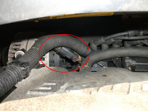

Yes, I did and it was a few things. One, I had a cracked ignition coil module..which contributed to the issue, but wasn't the issue. The MAIN thing wrong was that around the top of the engine in the middle on the back is a wiring harness....it was touching the manifold and melted some wires together. It is EASY to get this harness to be in the wrong place after a plug/plug wire change. It took out three different sensors.. crank sensor, throttle position sensor and another sensor I can't remember. What was happening is that the van was running on default settings while it was cold. When it warmed up and went into open loop mode to run off of sensor information...the computer was getting crazy data from the sensors.
Replaced the sensors, fixed the wiring and has been fine ever since.

WOW Thanks so much for your post... my mechanic and I were both REALLY scratching our heads with this too! Changed the plugs, wires, coils, and the same hose you changed from the PCV to the manifold. After each repair it would work for a while and then studder!
Is the wiring harness circled in this picture the one you refer to that melted?

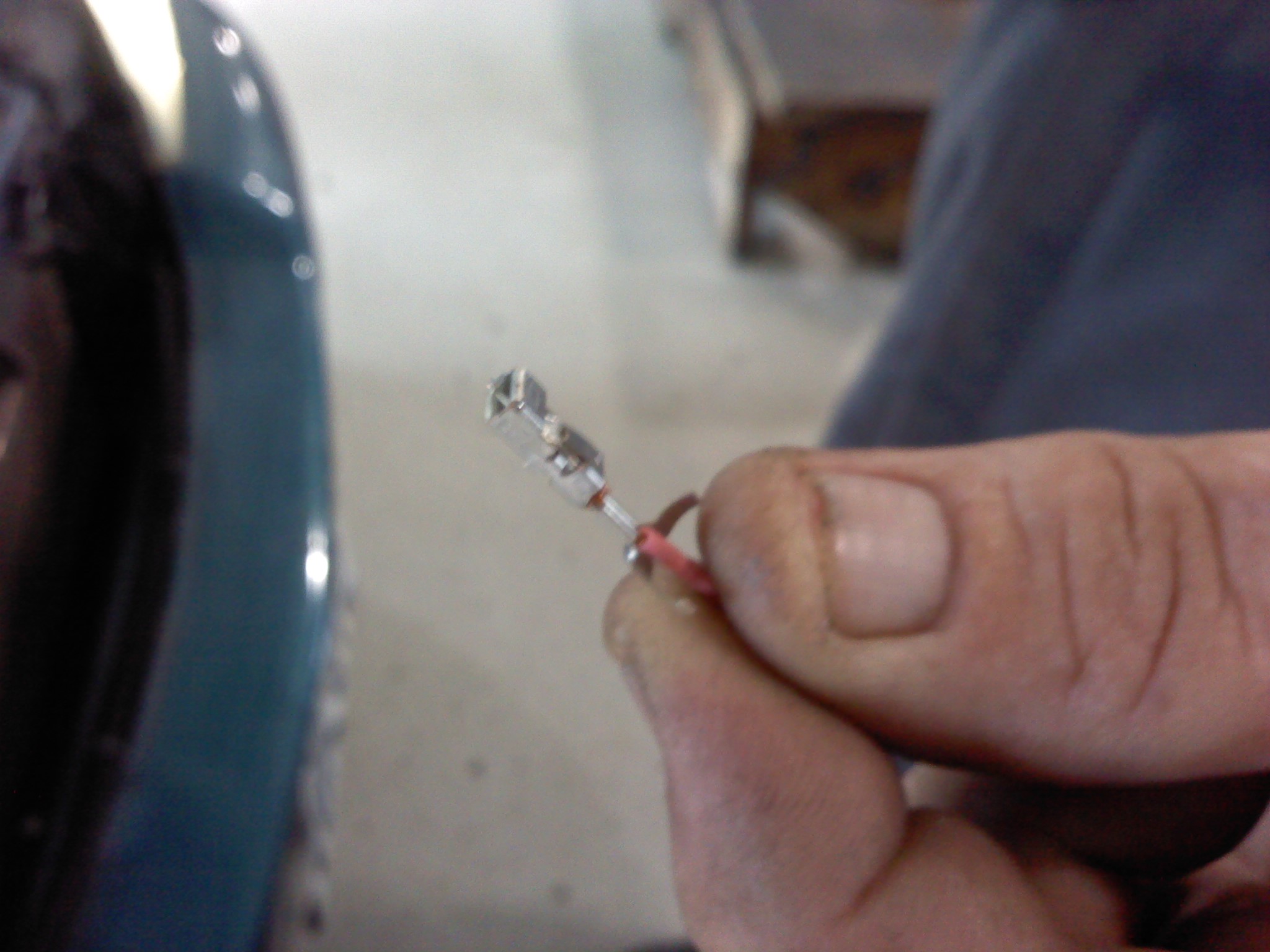

OK, I was on the road to FL last earlier this week, and the thing dies and leaves me stranded out in the middle of NOWHERE. $155 to tow it to the closest dealership, and 1.5 hrs later, this is what the guy finds...
Old Aug 2, 2012 | 2:14 PM
BlaneR's Avatar
Joined: Apr 2011
Posts: 41
From: Central FL
Default to finish...
That is the electrical power connector for the fuel injectors. It had gotten loose, and when it would heat up, it would cut power to the injectors. The mechanic put on a new connector and piece of wire, and I was off and running. Hasn't missed a lick since.
BTW, that connector is in that picture where someone circled it in red from 07-19-2012, 07:38 AM, I think.
