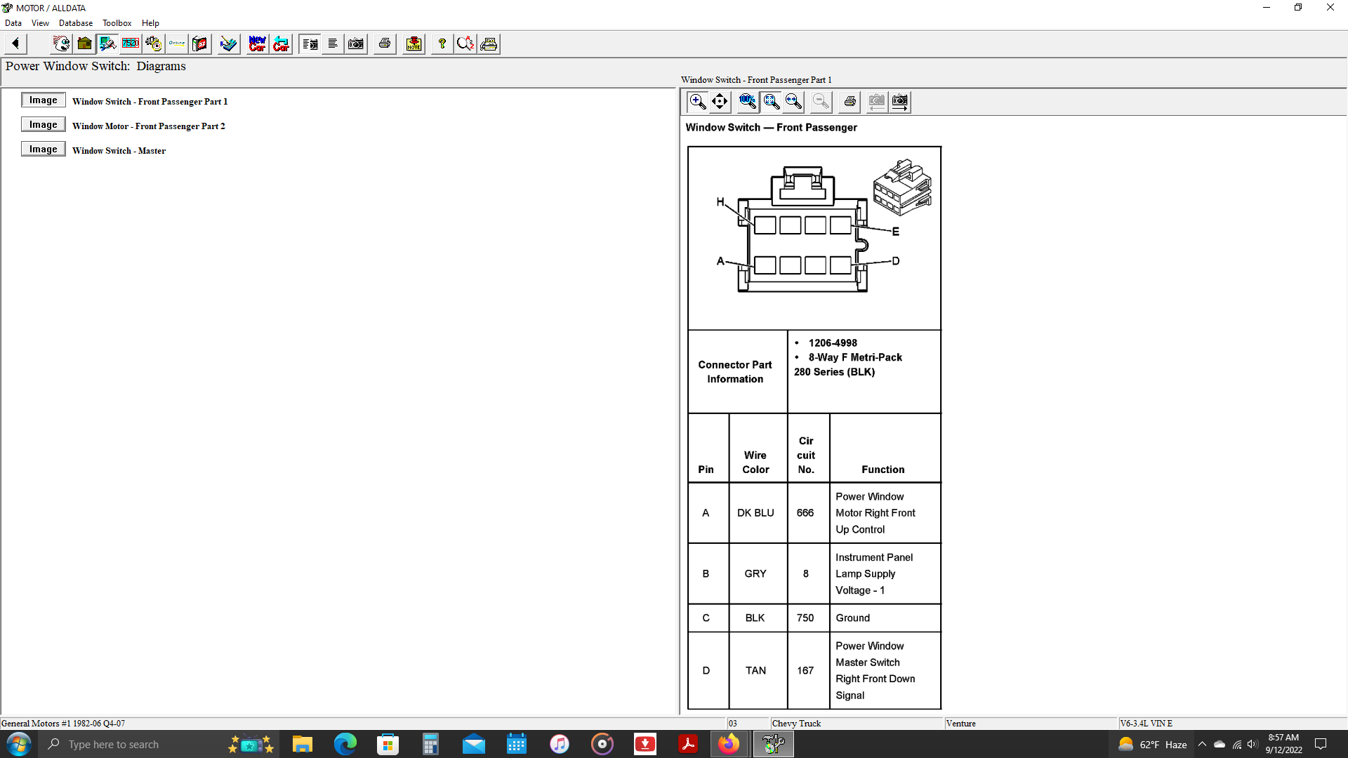

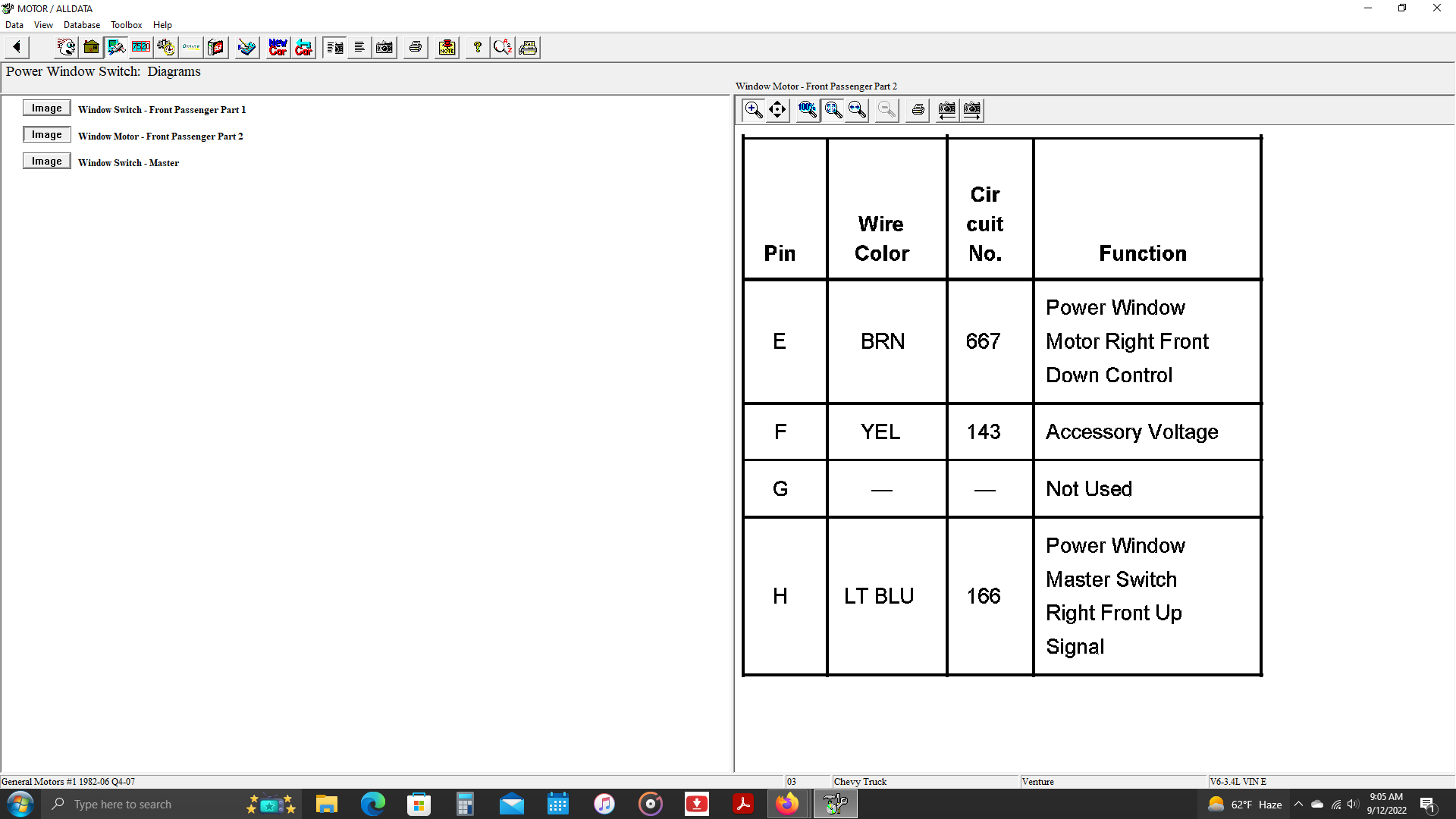

Here is some connections to check on right front switch.
