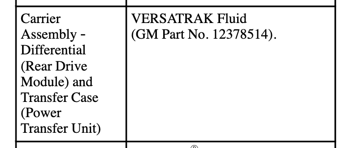

My question, the owners manual doesn't tell me what type of oil to use. I have heard on other forums that the rear diff(rear drive module RDM) takes Versatrak fluid. The only stuff I can find on Amazon says it's $32.00 per half qt I seen others complain that if they use RP Syncrho max that the RDM groans and grinds/ doesn't work very well. Is there an alternative fluid that works as well as the GM stuff, or am I stuck going to the dealer at $36.00/qt if I heard him right when I asked about that too. Also how much do I need, the owners manual doesn't tell me.
Also the owners manual tells me it needs replaced at 7500mi and then... Every 7500mi after that? That seems wrong considering I have 80k miles on this 02 Venture, and think I've only ever done the trans oil once.
Old Jul 21, 2020 | 4:39 AM
Likes: 690
it's right on page 7-23 of the manual.
The manual recommends checking and topping off the fluid at 12 month or oil change intervals. I don't see anything about draining it, but I would do it every 50,000 mi. Capacity is 2.1 quarts. I wouldn't use any other fluid.
