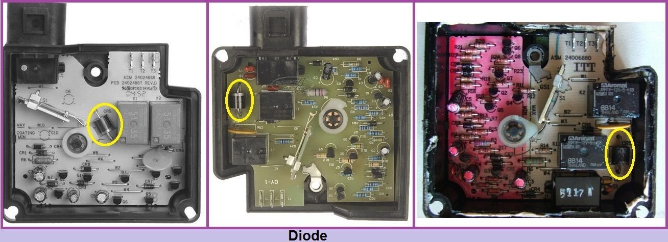

Hi Wendylolex !
I hope this video will help you

Hello everybody!
I agree with U.Nanimous . Perhaps the problem is the resistors on the control board is not functioning properly.
Often is out of order diode.
