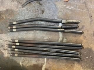

2) What would cause ONLY the intake valve pushrods to bend? I'll get a pic up ASAP, but once I had them all on the bench, it was so odd to me that only the intake pushrods bent (including the 3 that broke).

The only thing left to figure out is how only the intake pushrods were bent....

I never did figure out why ALL the intake push rods bent, but something was definitely wrong. I noticed after I put the correct timing set on that there was A LOT of valve train noise - much more than there should’ve been for a new cam and lifters. It was most obvious from the right head So I removed the valve cover and fired it up - the #6 exhaust and both #8 lifters seemed to be starving for oil and causing slack - there was hardly any oil reaching the rockers. By comparison, all the other lifters/pushrods were shooting oil all the way to the fender.
It was running otherwise good but you could tell it was missing on those cylinders. I thought maybe some debris had collected in the galleys that fed those lifters, so I tried adding sea foam to the oil and drove it to get the temp up, then when I got back, revved it at 2500-3000 for a solid 5 minutes hoping that would do the trick. But no such luck.

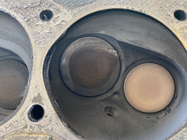

I had to move on to other things, so it sat for a while. Unfortunately I didn’t get the chance to resolve it - our customer needed the truck so they decided to put a Jasper reman in it. However, before we sent the core back to them, I took a little time to pull the heads just outta curiosity.
It’s interesting how a non-interference engine managed to find some interference... this is on #6 - the only cylinder that showed signs of this - yet, the valve isn’t bent.

Interesting read. I would think the only thing which would cause all the intakes to get kinked and not exhaust would be valve timing. Don't know specifics on this engine but would assume that when the cam gear stripped initially it put intake in contact with piston but not exhaust. Last pic appears to be the contact evidence. So the mystery to me is how it seemed to run at all after the push rods/potential valves where kinked? The one experience I have with timing chain slip was catastrophic death of engine immediately so I've assumed that's the way these failures happen. Maybe it's not always catastrophic death? maybe it's possible to contact/kink valves/pushrods slightly and once not straight it's just a matter of time before they seize/break/bend more - don't know. maybe someone else has different experience.
It seems either that or you put something together wrong somehow but seems you know what you are doing.
Old Jul 13, 2020 | 12:09 PM
Gumby22's Avatar
Joined: May 2011
Posts: 1,578
Likes: 302
From: Central Iowa
There’s quite a bit of history on this truck. When it was new and only had like 20k on it, the engine was rebuilt by the local GM dealer due to a factory defect (can’t remember exactly what - this was second hand info from my boss who knows the original owner). The rebuilt engine had about 170k on it when it came to me for the no start.
Almost every manufacturer today uses interference engines (instant death when timing chain/belt jumps) but the GM big blocks like this one were non-interference, meaning even with a valve fully open, it should clear the piston at TDC, but the ignition timing being too far advanced for too long could have caused the intake rods to bend.
As for the clash on the #6 exhaust, I suspect the valve springs were weak due to age/mileage. Then the new lifter, whether defective or clogged up with debris, didn’t allow pressure to bleed off correctly, and so the valve opened further than it should have and they hit. But I won’t be able find out for sure since I didn’t get the chance to further diagnose it.
