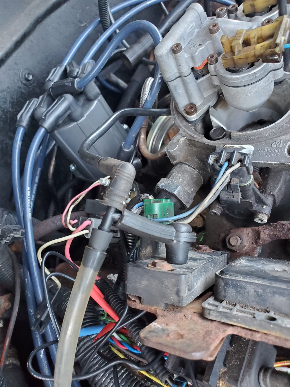

The connector didn't work still no iac movement and no start. No vacum when I crank the engine over when I plug the mighty vac like the picture. When I pump vac myself it will hold 17 steady. Not sure if I should be plugged in somewhere else.

The first place you tried to measure vacuum was the MAP sensor port - it should’ve had full manifold vacuum on it.
The brake booster line should also have full manifold vacuum.
It’s possible unknown blockages or the engine hoses are leaking and preventing accurate vacuum testing, So here’s what I see as your choices at this point:
1) Try one more time to check for cranking vacuum on the PCV return port - it should also have direct manifold vacuum. Don’t tee into the line, just hook your gauge hose directly to the port.
2) Try holding your hand(s) over the TB barrels as a helper cranks the engine and see if you can feel vacuum against your hand.
3) Proceed with compression testing.
4) Try dropping the exhaust to check for restrictions. If you decide to drop the exhaust, I’d recommend just pulling the pipe off the manifolds - then you can crank it and see if it starts, even if it’s only a quick fire before it dies.
