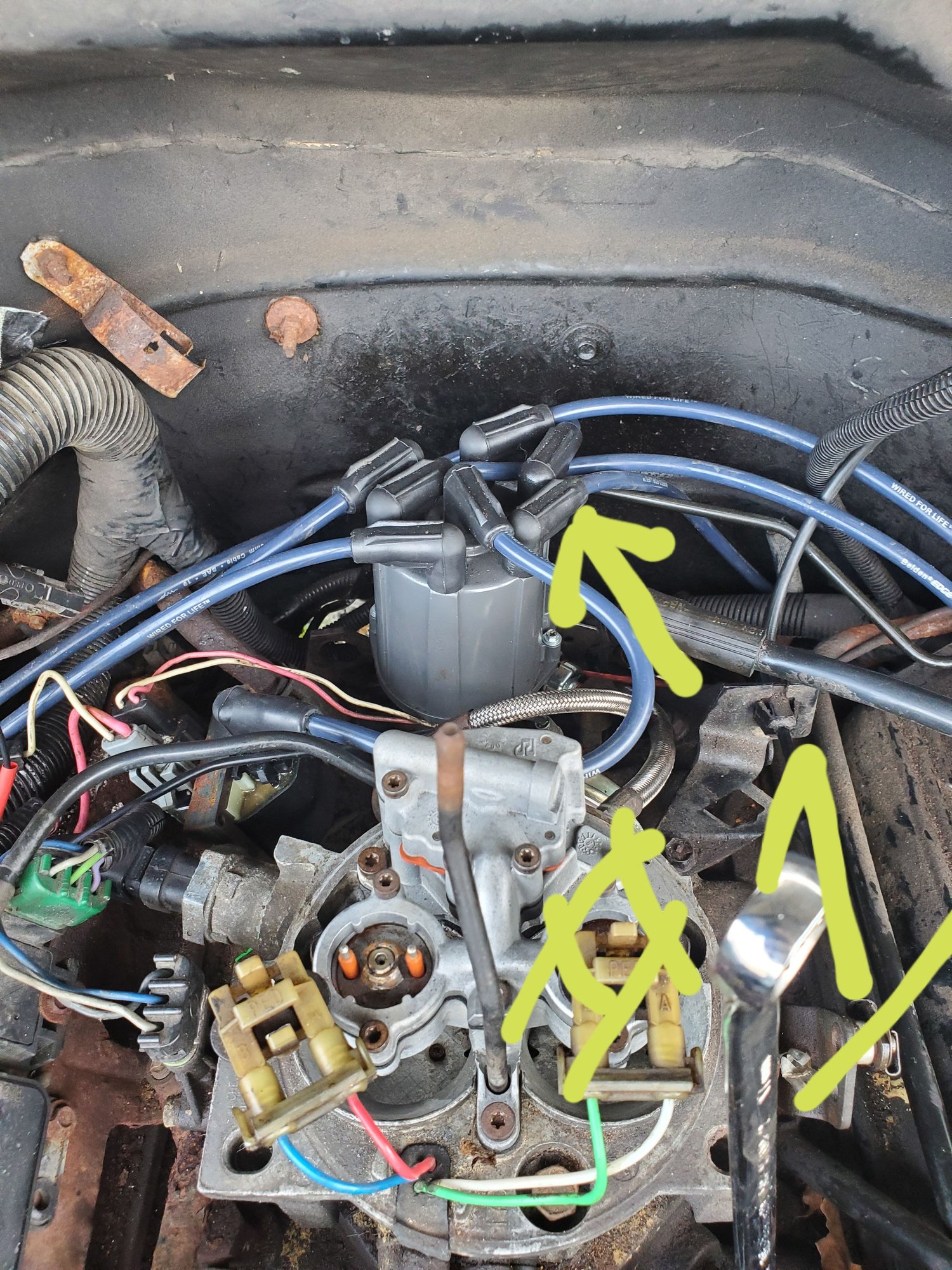

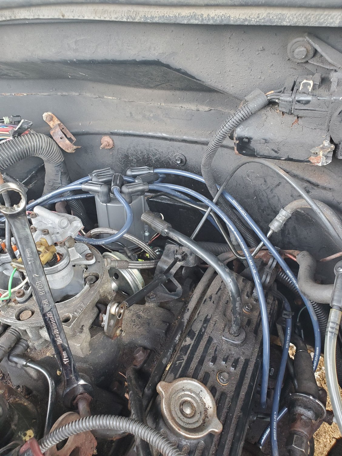

I bought a timing light and I'm beginning to notice something when light flashes when rolling over and timing mark is at 0 degree on timing tab mark the distributor cap looks way left to me. I will post some pictures

So I will fix that tomorrow and charge battery up good and do the vacum test again.

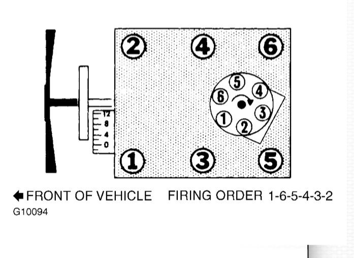

Here’s the cap layout and firing order for the 4.3
If the timing chain or distributor drive gear is off by only one tooth, rotating the distributor should compensate well enough to at least get it to fire and the actual change can take place once it’s confirmed. Which way you have to turn it depends on whether the timing is advanced or retarded (determined by the chain or distributor gear being off), so it will take some trial and error.
Make a reference mark on the base of the distributor where it seats into the manifold so you know where you’re starting, and can keep track of where you were.
