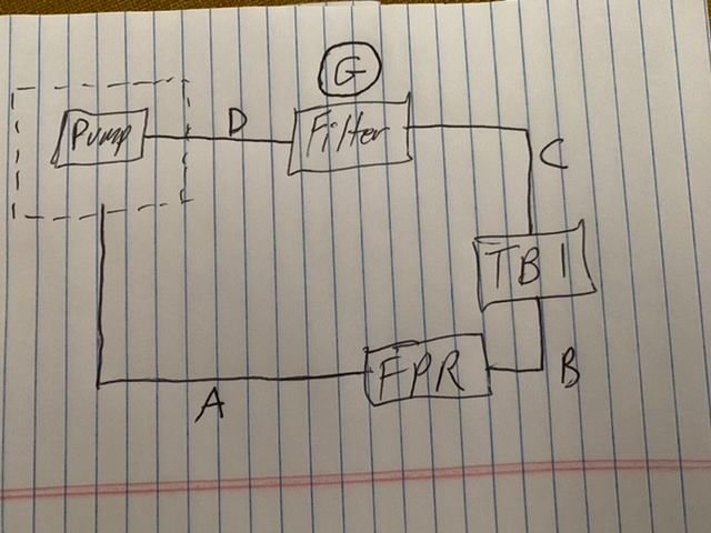

I didn’t watch the last couple of minutes of that TBI video, but I agreed with everything he said up until the comment regarding the FPR being bad if you pinch off the return line. It’s just not accurate.
Refer to the “professional rendering” of the fuel delivery system below.
Of course the FPR is part of the TBI but I wanted them separate for the sake of clarity as the direction of flow through the system puts the FPR technically downstream of the TBI, and it will help demonstrate the point.
In the video he states to use an adapter in place of the filter for the gauge - masterfully represented by the “G” above the filter. So if you pinch off the return line downstream of the FPR (point A), everything upstream of the return line is now receiving the maximum pressure the pump can provide, including the FPR.
So what’s the explanation if you cut off flow at points B or C? The gauge will still register the max pressure of the pump, yet at those points in the system, the FPR is fully removed from the test.
However, if you were to pressurize the system and then pinch off the line at point D, then saw a complete loss of pressure, the FPR could be at fault.
Given the difficulty you’ve had in getting the truck to run it wouldn’t surprise me if both the FPR and the pump are bad, but at this point you know the pump is delivering good pressure so tearing down the injector body for cleaning and replacing the FPR is where I’d start too.
If it still loses pressure that quickly with a new FPR, the pump check valve is for sure faulty, but that doesn’t mean the pump itself is bad. For the purposes of getting it to run, I’d recommend turning the key on and off a couple of times to build pressure before cranking.
