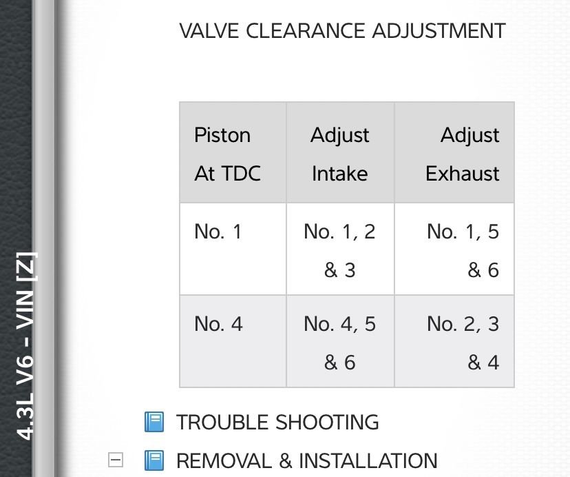

How are you adjusting the lash? The recommended spec is to tighten the adjusting nut until the pushrod won’t spin, then tighten one more full turn.
Here’s a screenshot of which valves to adjust and when. After the valves with #1 are adjusted, it should only take one full turn of the crankshaft to bring #4 to TDC.
You could also follow the firing order - it takes longer but allows you to adjust both valves on one cylinder at a time.

That is super helpful thanks. I was doing it like the Ellis machine shop YouTube video. After the adjustment you posted It was making more firing noise and also you could see smoke rising from iac hole after trying the start. So I took other valve cover off and adjusted them as well. Also put the distributor back to where it started which was 3° retarded or approximately. No start and it doesnt try to start like normal. So I am going to put them back best I can to where they started.
