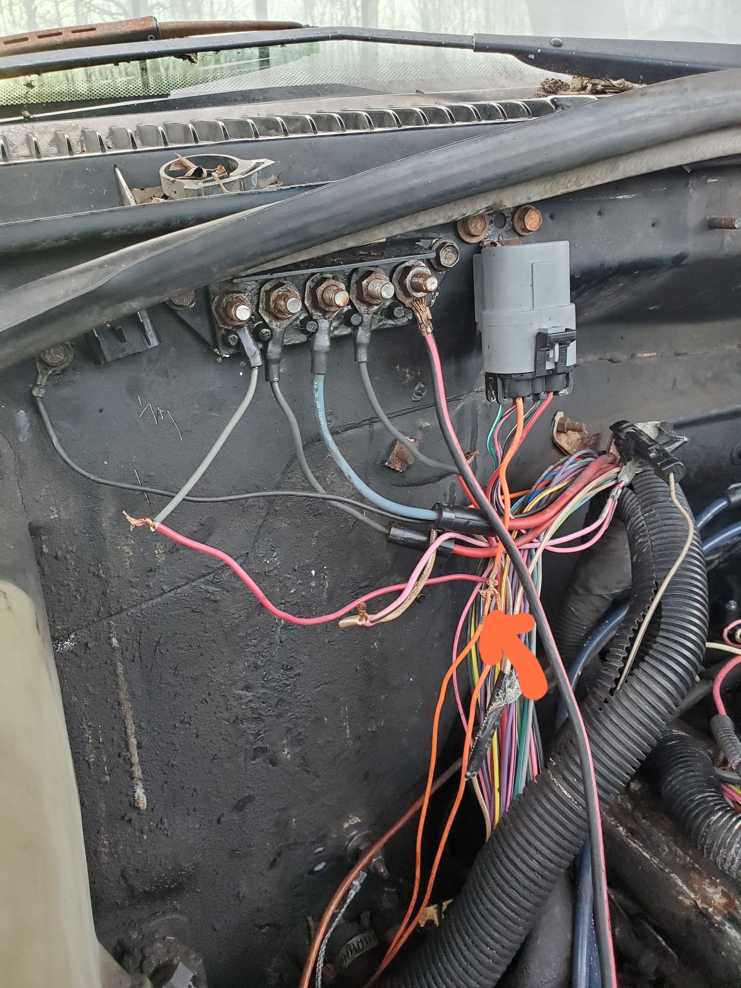

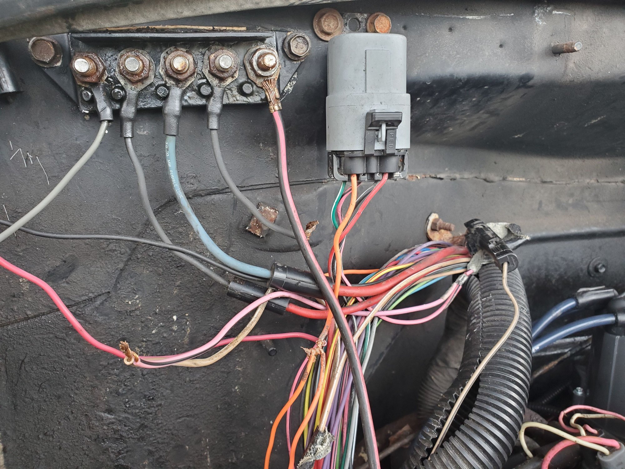

One thing I remember 6 yrs ago when truck quit there was a wire on firewall block and 3 orange wires so I assumed it got unhooked so I hooked it back up. I can't seem to find a picture of a proper firewall wiring to the junction block of the orange wires. Wiring schematic isnt helping me.
You will have to physically trace them

This is how mine looks now
