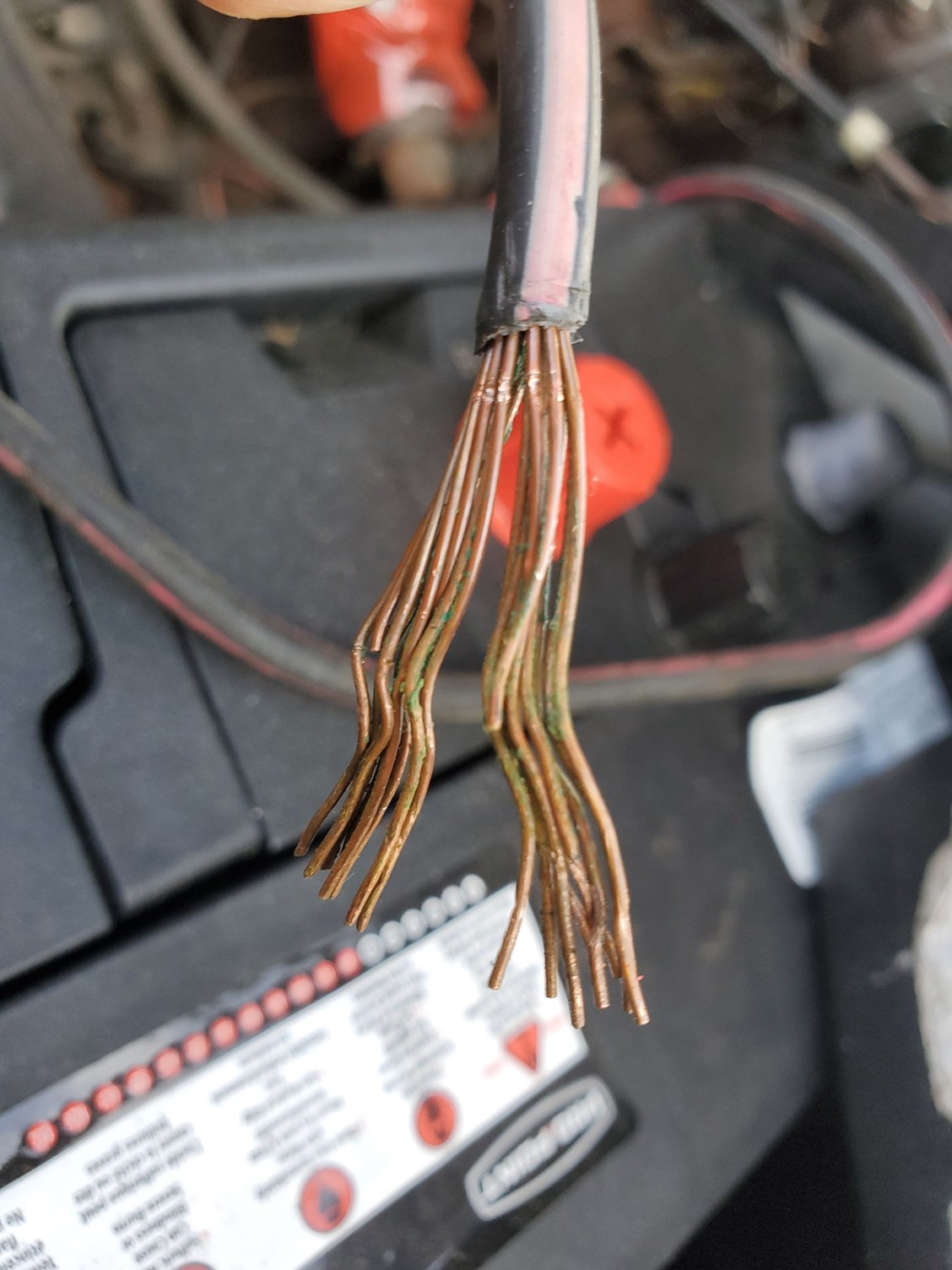

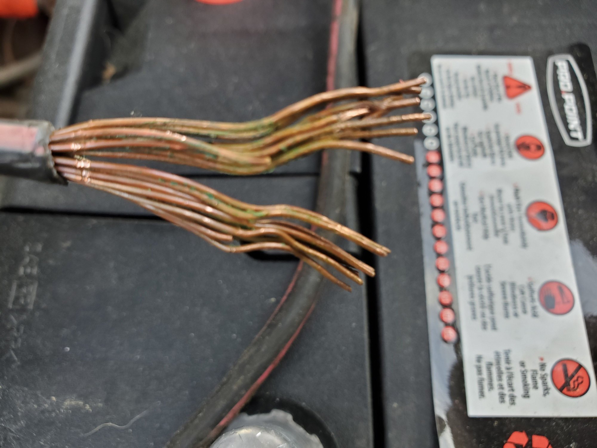

Now that I watch the videos I need to tighten and fix the black with pink stripe wire that isnt firmly crimped tight on firewall. I notice when my kido hit key starter took a bit to kick and I believe when I look at wiring schematic that pink black wire also controls ecm stuff.

The pink striped wire has corrosion inside entire wire somewhat as does the thicker starter wire.

The pink/black wire is an ignition feed for several components including the ECM. The corrosion isn’t helping but it doesn’t look that bad either (unless it’s worse in other places) - replacing the eyelet and making sure it has a good crimp should be sufficient for continuing diagnosis.
Check for battery voltage with the key on - if it’s within 0.5 volts consider it “good enough for now” and then cut the end off to get some fresh copper for the new eyelet.
