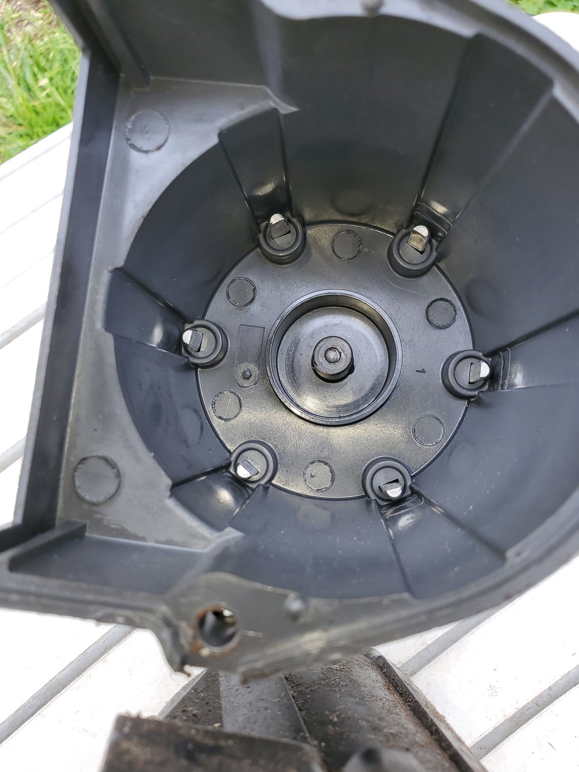

I found a broken distributor center button really hope a new one will get it started
I'd suggest without the cap, crank the engine make sure the rotor is turning free. Old school even with a new cap, if you have a trouble light, put the cap under it to check for cracks in the cap.
You gotta love it when something this simple ends up being the cause…. I really hope that’s it!
I’m in agreement with kevinpk though - with the cap off, verify the rotor is turning at a consistent speed, just for verification. Just remember to either unplug or ground the coil first…

Yes me too I actually verified rotor speed like you suggested just before I found cap was broken. I mounted rotor wrong the other day so could be I broke it then but when I look at older video truck has same symptoms so really hope I found the last problem preventing it from starting.

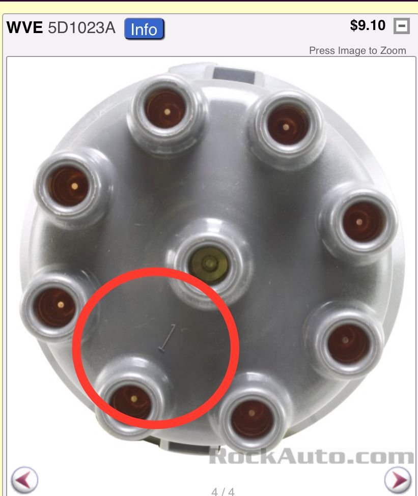

Thanks for posting firing order awhile back gumby. When I google firing order for 1988 Chevrolet cheyenne k1500 4.3L i get so many conflicting results. Also does the #1 inside cap have a meaning?
Old Jun 12, 2021 | 2:32 PM
  #90
Gumby22's Avatar
Joined: May 2011
Posts: 1,578
Likes: 302
From: Central Iowa
It probably has a meaning to the manufacturer, but usually caps that mark the #1 tower for identification are marked on the top between the tower and coil hookup.
Edit - This is a cap marked for the #1 tower
