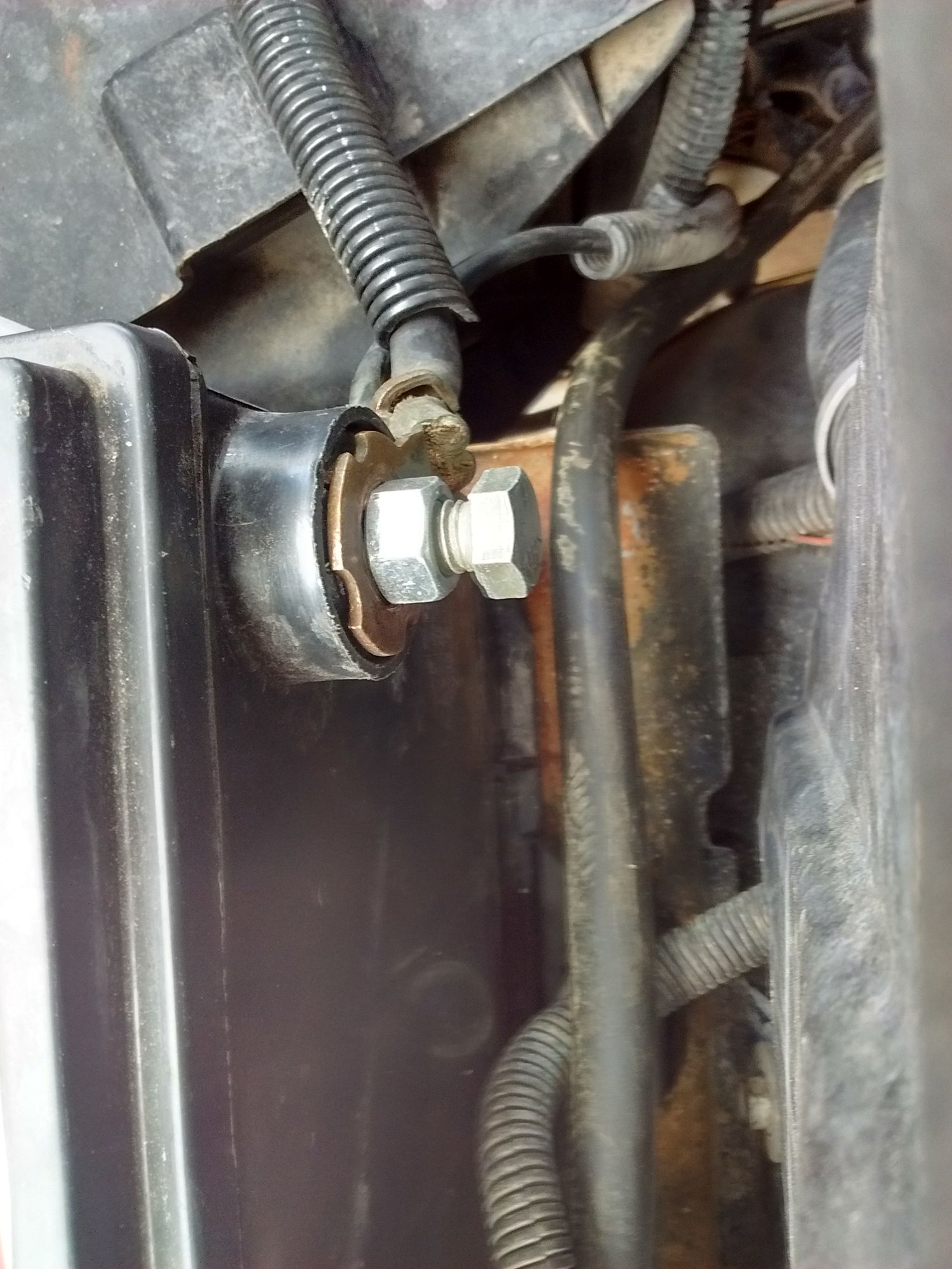

Pic is a little bigger than I expected! Anyway I found this to be the best way to mount side mount battery cables. 3/8" x 1" bolt and nut. Thread the bolt as far into the battery as it will go then tighten down the nut. You can go pretty tight on the nut without worrying about stripping out the threads of the battery. Much better than OEM.
Looks kinda like my Mazda, crappy cheap battery clamp. These things over time will cause corrosion at the post.

the only issue with doing it this way (which is the way i was talking about before) is the bolt you can actually penetrate the battery terminal if you screw the bolt in too tight. what i do is tighten it down by hand then back it off a little so its not making contact. when you screw the nut to tighten the bolt should move any but have another wrench on the bolt to ensure it wont move
OEM Chevy, just without the rubber boot,
Right, I only hand tighten the bolt and use a wrench on the nut.
