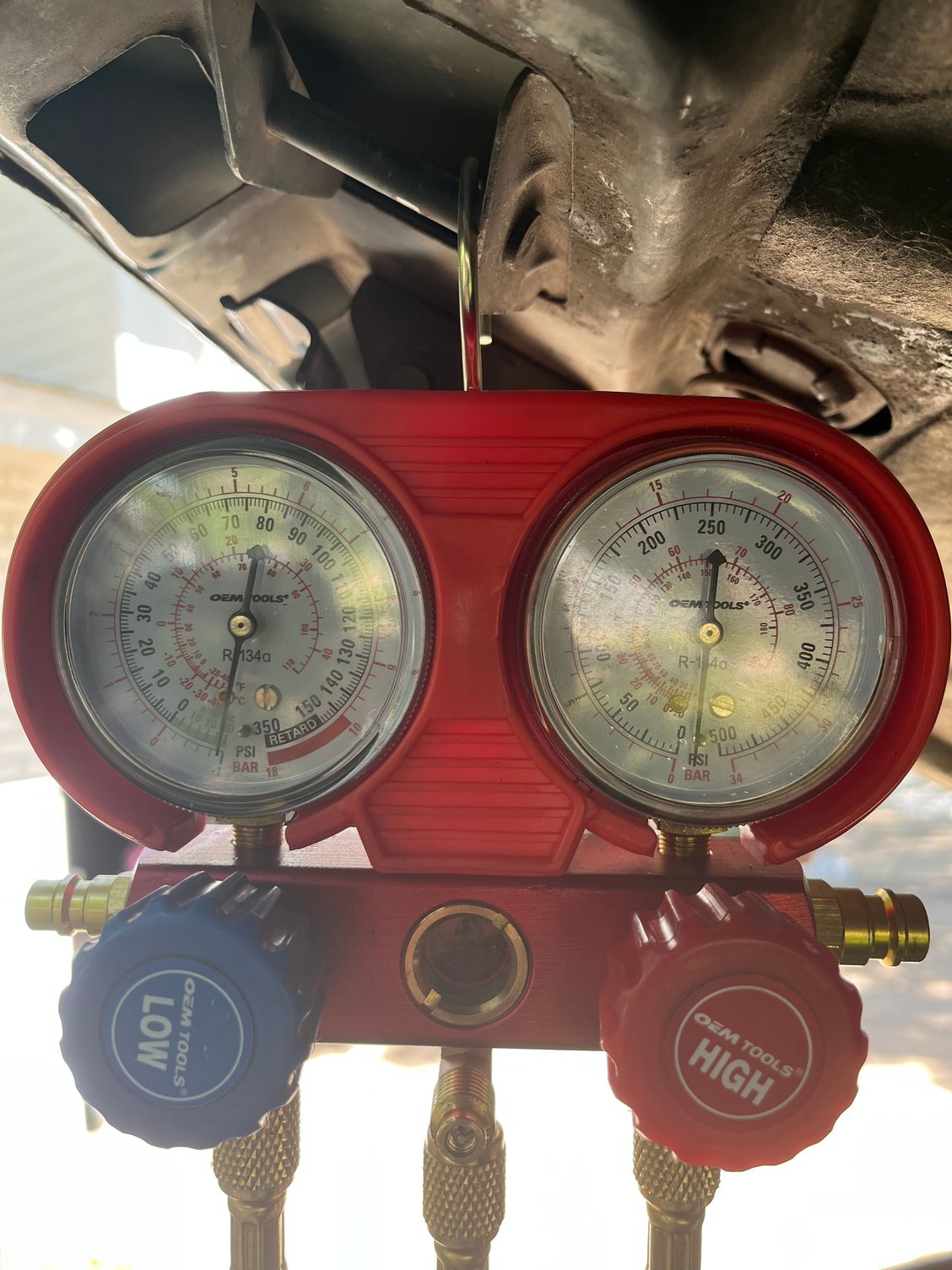

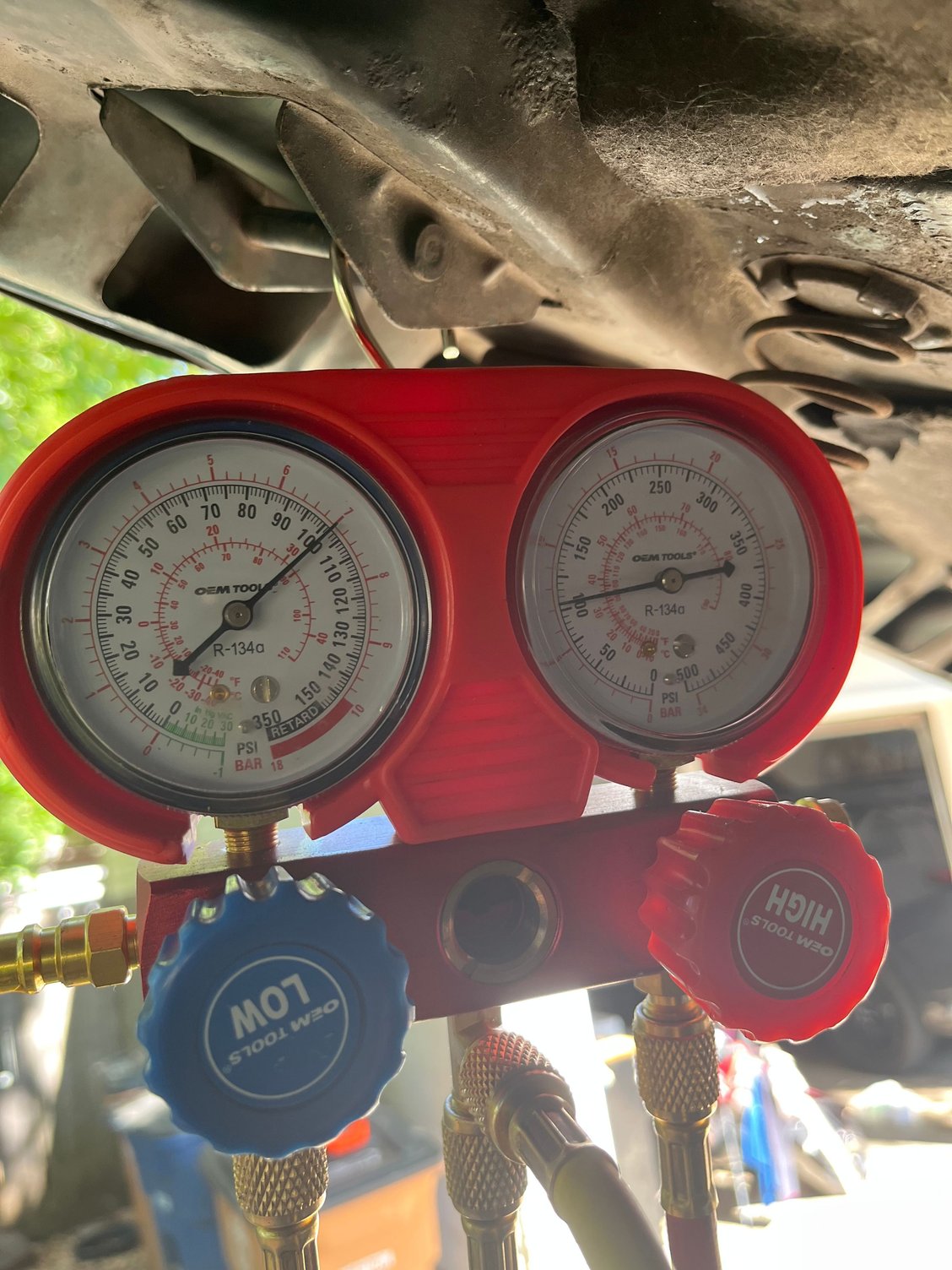

I vacuumed the system and it was holding pressure, I added not even a full can of Freon and the high side was way too high and the compressor didn’t kick on.
below you’ll see it holding vacuum and the readings after the one can of Freon.
I

Not that this would be a cause, but the pic of the post-vac readings shows the low side is not in a complete vacuum. The needle should be up against the stop like it is on the high side.

At 100* those pressures are normal for the charge level (approx 38% system capacity for standard cab - if it’s a crew cab it would be about 33%).
Static pressure should reflect the ambient temp within about 10 PSI. The curve changes above 80* but my experience with AC has taught me it’s still reasonably close up to 100* if the system charge is not excessively low or high.
If I’m not mistaken, both the high and low side service ports are on the compressor line assembly, so for the pressure to reach 300+ PSI immediately indicates a few things.
