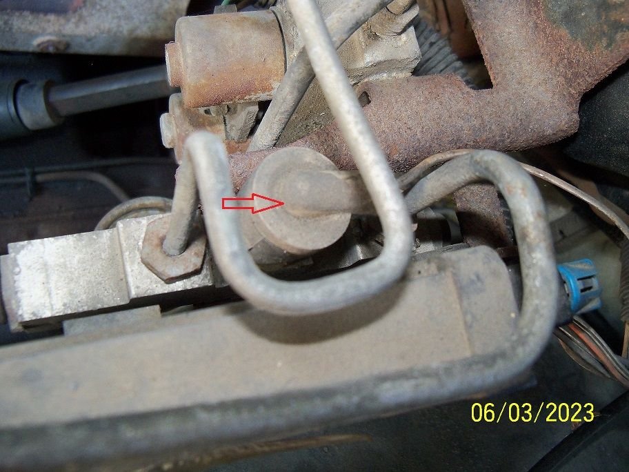

When applying the brakes the right rear grabs,(locks up), real bad especially when I first drive it in the morning when damp/wet. After I ride the brake a little it is not as bad but still grabs. The wheel does release as soon as I let off the brake.
I see 3 connectors on the RWAL. Is this what I disconnect??

The 2 connectors in the 2nd picture are for the RWAL module - the one in the first is for the red brake warning lamp on the dash.
