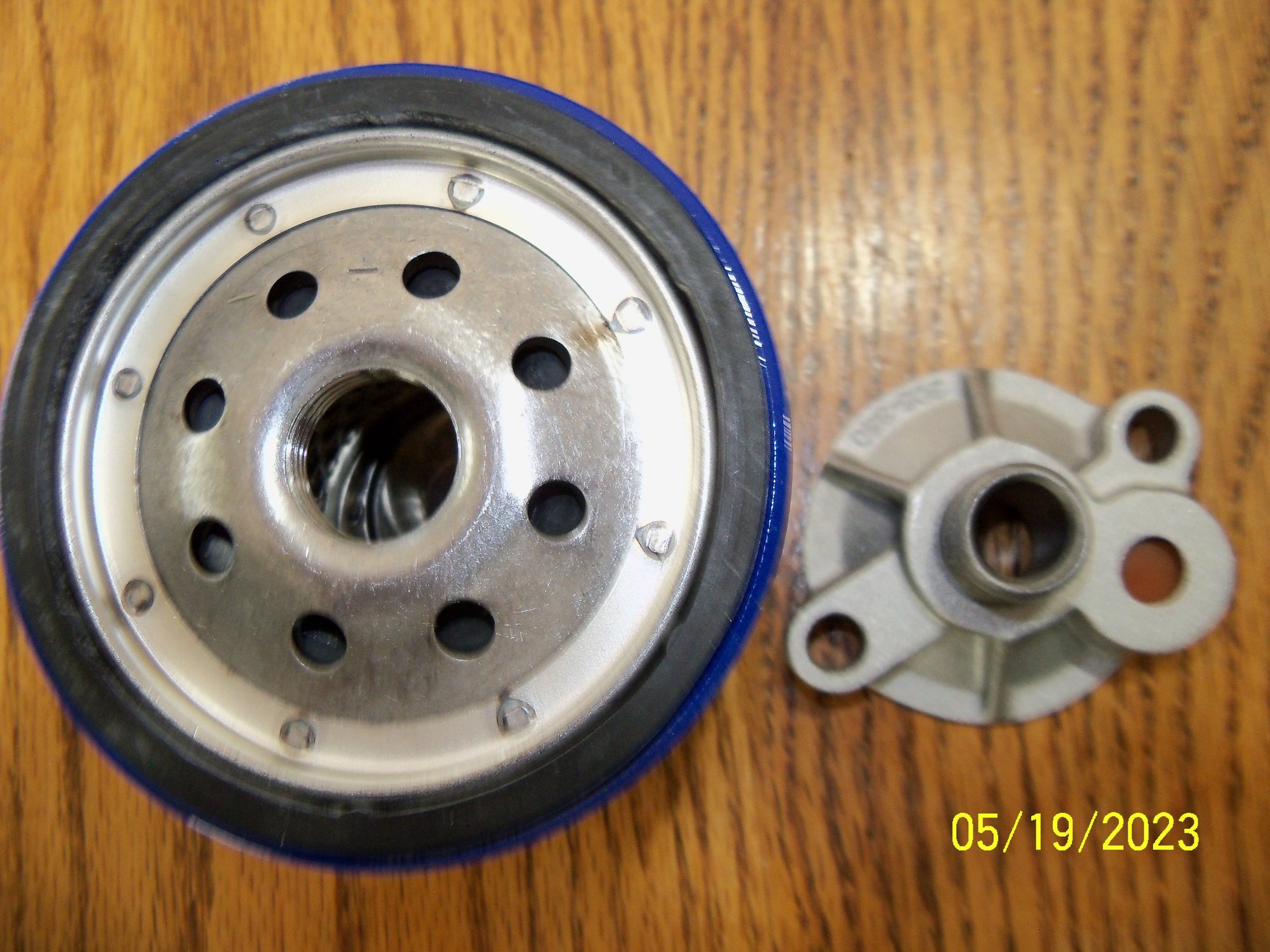

I am confused. I just got the adapter & filter, bolts & gasket. The picture shows the adapter & filter. What else is need to attach the filter to the adapter or is that already on the oem adapter on the truck. As you can tell I am not a mechanic.

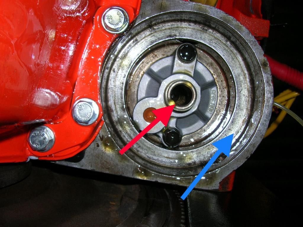

I may be misunderstanding the situation, so here’s more detail:
I recall a previous thread about your cooler lines. Am I mistaken in thinking you have a sandwich plate style adapter for the oil cooler? If so then it’s bolted in place of where the oil filter will be once it’s removed.
See picture below - this is the block without an oil cooler adapter.
The filter adapter is bolted to the center of the bore. The red arrow marks the filter bung. The blue arrow marks where the oil filter gasket will seal against the block.
It sounds like you have everything you need to delete.
EDIT: Here’s the picture I meant to attach the first time.
Red = Filter bung
Blue = Filter gasket surface
Red = Filter bung
Thank you very much for the info. I see now how it works. When I received these parts yesterday I was totally confused. This adapter actually goes up inside the block. Thanks again.
