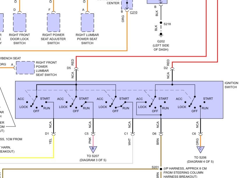

Here’s the ignition switch schematic - you can check the wiring by back probing at the connector at the base of the column by removing the trim panel.
Power in but no power out, particularly in the ON/RUN position means the switch or column wiring is at fault.
The red wires are fed from the IGN A & B fuses in the underhood fuse block.
