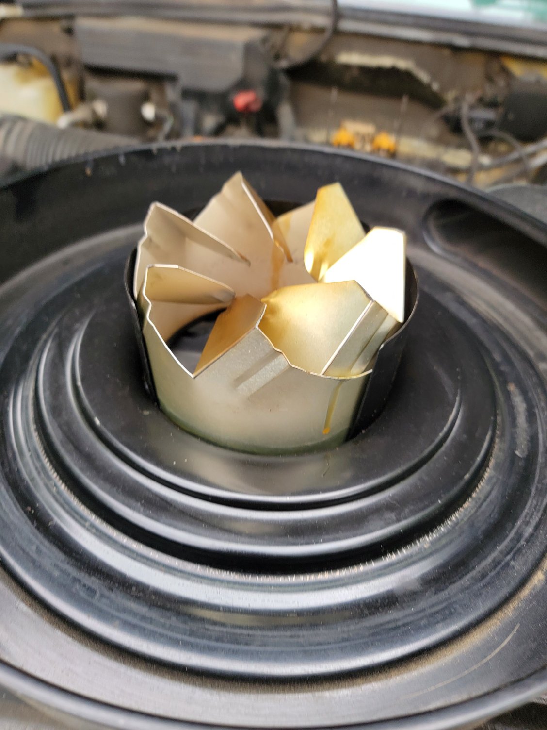

Hi gang,
I am new to the forum and recently bought a 1994 Chevy C2500 (Silverado pkg). It has the 454 Big block as an engine.
Please see attached pic. This weird metal thing is attached to the body of the air cleaner. It rests on the TBI. I have never seen this before and do not know what it does.
Does anyone have an idea. Can I remove it from the body of the air cleaner?
Thanks
Old Sep 17, 2021 | 2:27 AM
Photon440's Avatar
Joined: Sep 2017
Posts: 97
Likes: 3
It appears to be one of those add-on Vortex air intakes. They claim to boost mileage and horsepower by redirecting the airflow. They're legal in all 50 States because they don't really do anything at all.
I would remove it.
Old Sep 17, 2021 | 6:26 AM
Thewop74's Avatar
Joined: Sep 2021
Thanks for the reply Photon. It will be be part of a delete this weekend.

I have heard of them, but this is the first time I actually saw one.
There are people out there just waiting to get into your wallet with useless add ons !.
Old Sep 20, 2021 | 7:37 PM
Gumby22's Avatar
Joined: May 2011
Posts: 1,578
Likes: 302
From: Central Iowa
The idea is if the air is spinning (like a vortex), its speed will be increased and, in theory, more air will enter the combustion chamber, resulting in increased fuel efficiency and engine output.
The problem is the throttle plates immediately interrupt any change in air direction or speed, so any theoretical gain is lost before it even gets past the throttle body.
The theory itself isn’t anything to argue with - it’s why many vehicles utilize plastic molded intakes that force the air into a full or semi-circular path, or have runner control valves - but theory and application are 2 different things.
This is, however, the first time I’ve seen one on a TBI. Someone was hoping for a miracle.
Add a few zeros to your MPG/HP/torque ratings and you’ll get the same deluded sense of relief as the PO got when they installed that thing.
