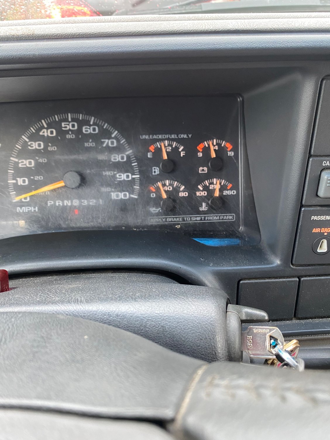

This was after changing out the sensor just sitting at idle from what I’ve seen this is pretty good but, it will still gets pretty low every so often but it’s usually sitting there.

Posts: 6,232
Try a heavier weight oil. You can also add some STP oil additive to see if it makes any difference.
Did you verify the actual pressure with a mechanical gauge?
The rule of thumb for oil pressure is 10 PSI per 1,000 RPM once the engine is at operating temperature - if it’s still slowly dropping off, verify the issue with a mechanical gauge. If the mechanical gauge isn’t reading the same as the gauge, it’s still an electrical fault.
The clusters in these trucks are known for having problems with the stepper motors - that will be the next step if the mechanical gauge doesn’t support an actual loss of oil pressure.
