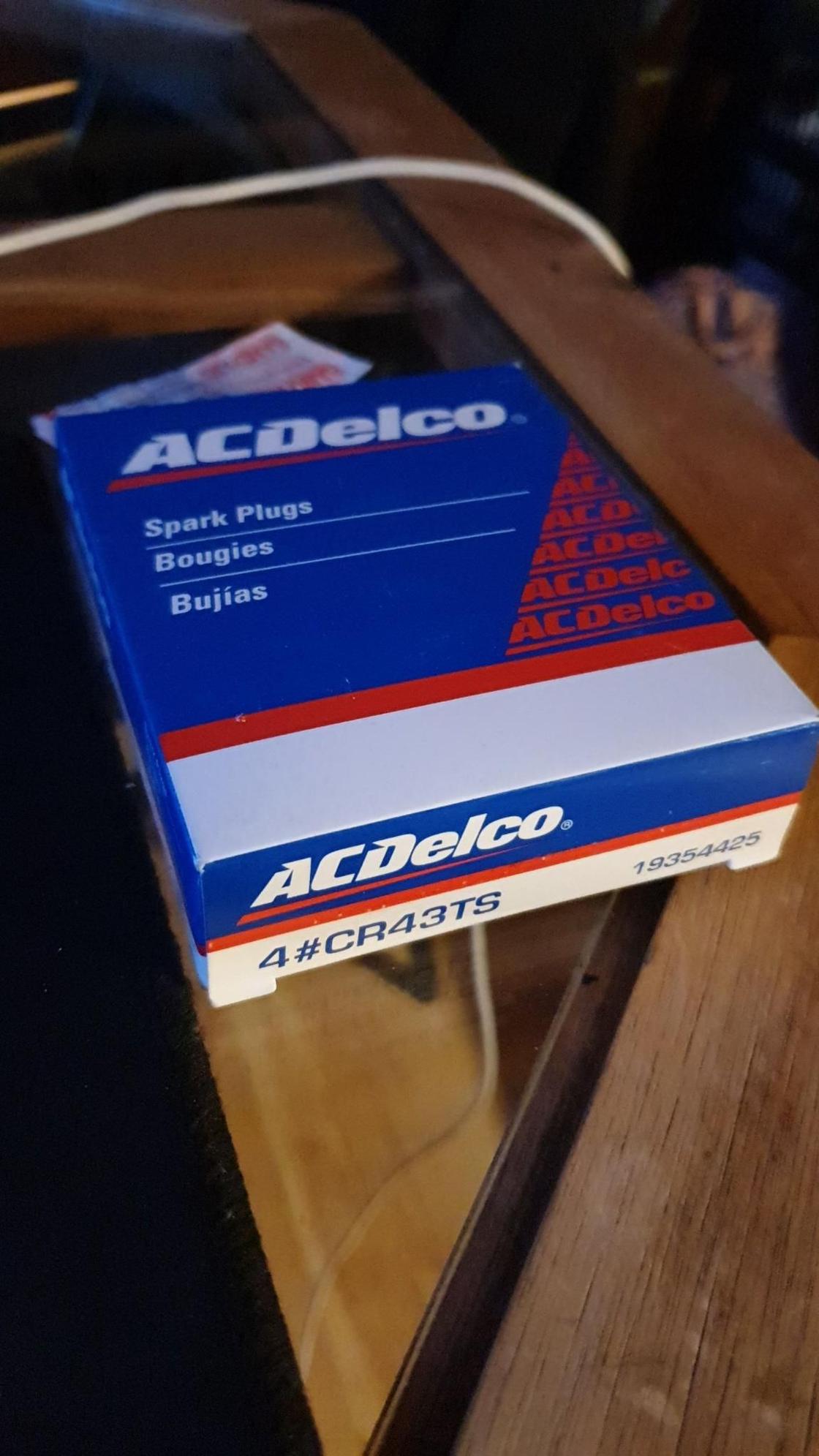

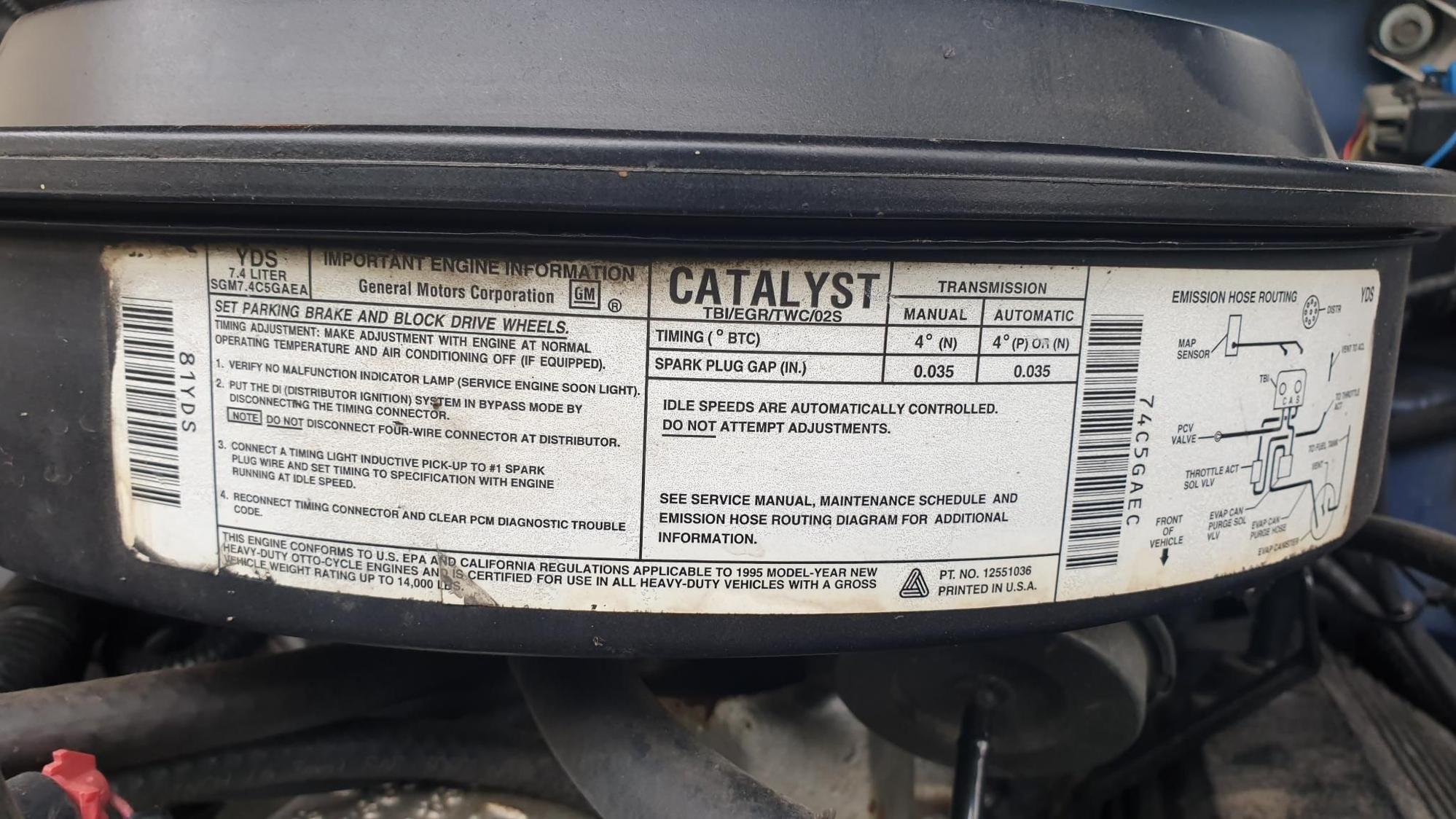

Hi, I have a 1995 Chevy Suburban K2500 with the L19 454 cui.
I need to know to what to do. Coz I bought AC DELCO CR43TS 19354425 spark plugs due to be recommended for my Truck, but later finding out, that the Pre-Set Gap: is 0.044.
On my Airfilter box it says, my truck needs 0.035.
So I wonder what to do? Can I run those Delco CR43Ts or should I get other plugs asap?
Thanks for your response.
Old Jun 6, 2024 | 12:58 AM
service manual says 35 thou.
https://charm.li/Chevy%20Truck/1995/...pecifications/
Old Jun 13, 2024 | 7:06 PM
Strike's Avatar
Joined: Dec 2021
Im traveling. And I do not have a spark plug gapping tool.
So should I buy other spark plugs with a 0.035 gap and throw those AC DELCO´s away or could I continue driving?
So far I drove about 800 KM on the AC DELCO´s....
Old Jun 13, 2024 | 7:33 PM
Rednucleus's Avatar
Joined: Jul 2014
Posts: 2,346
Likes: 311
From: Marysville, WA
You can get feeler gauges at any auto parts store. If it's running ok no big deal, just re-gap them when convenient. Certainly don't discard new plugs that just need a gap adjustment!
Old Jun 14, 2024 | 12:12 AM
Strike's Avatar
Joined: Dec 2021
Thank you!
