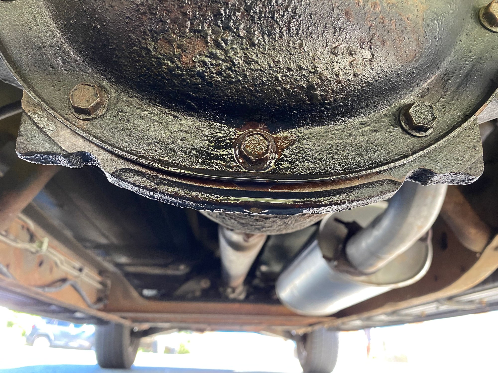

post a pic of the leak area.
if leaking from the cover....did you clean the mounting surfaces? if from the pinion or axle seals...if the diff vent plugged?

Thanks for the reply tech2. Here are leak pics. Seems to be coming from the bottom. I did clean the surfaces, used parts cleaner and also scraped off the old gasket remains. Seemed more like a rubbery goo than a true gasket. I read elsewhere to only scrape with a plastic tool. I did use a metal scraper and a screw driver. Did I damage the cover? If so how to remedy? Anyone think I should try Blue Devil Oil Stop? Redo the gasket with a sealant gasket maker as well?

You don't want to scrape on a machine matted surface which is not the cover. If it's leaking around the threads, I might suggest a metal washer and O ring.
Old Sep 27, 2021 | 4:00 PM
drain the diff; catch and save the fluid. clean the surface and dry wipe with brake cleaner. throw the gasket out and use rtv. I "like the right stuff"

May be an optical delusion but looks to me like the cover is bent outward where it's leaking - maybe got pried open there??

Thanks again to all who have replied. I am curious about the possibility of a bent cover. I don't think it is, and I know I didn't have to pry hard to separate it when I drained it the first time. I think I will drain it and use RTV...hopefully that will settle the problem. Anyone advise against replacing the cover?

Place to cover on a flat surface, sets flat it's good.
