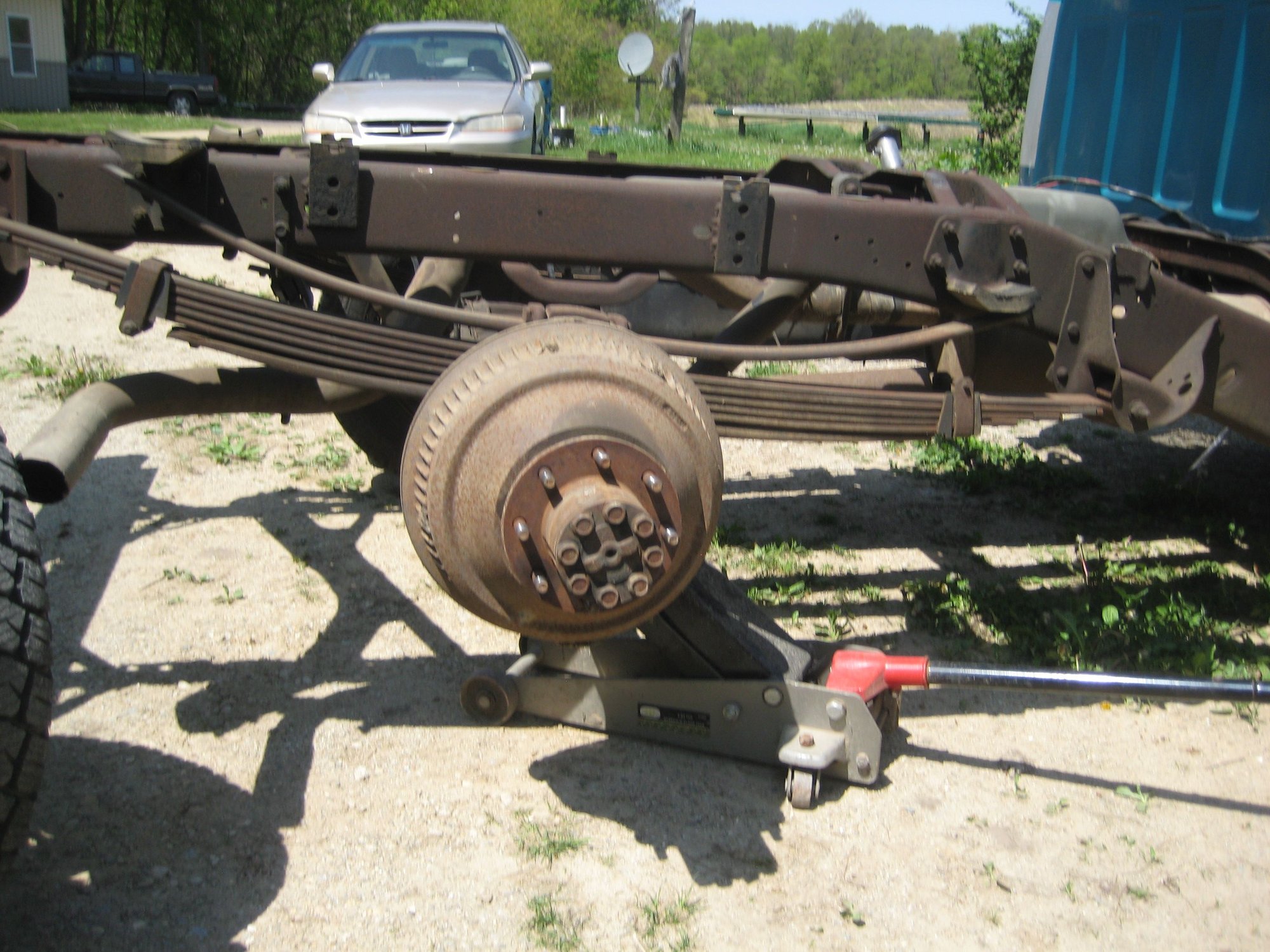

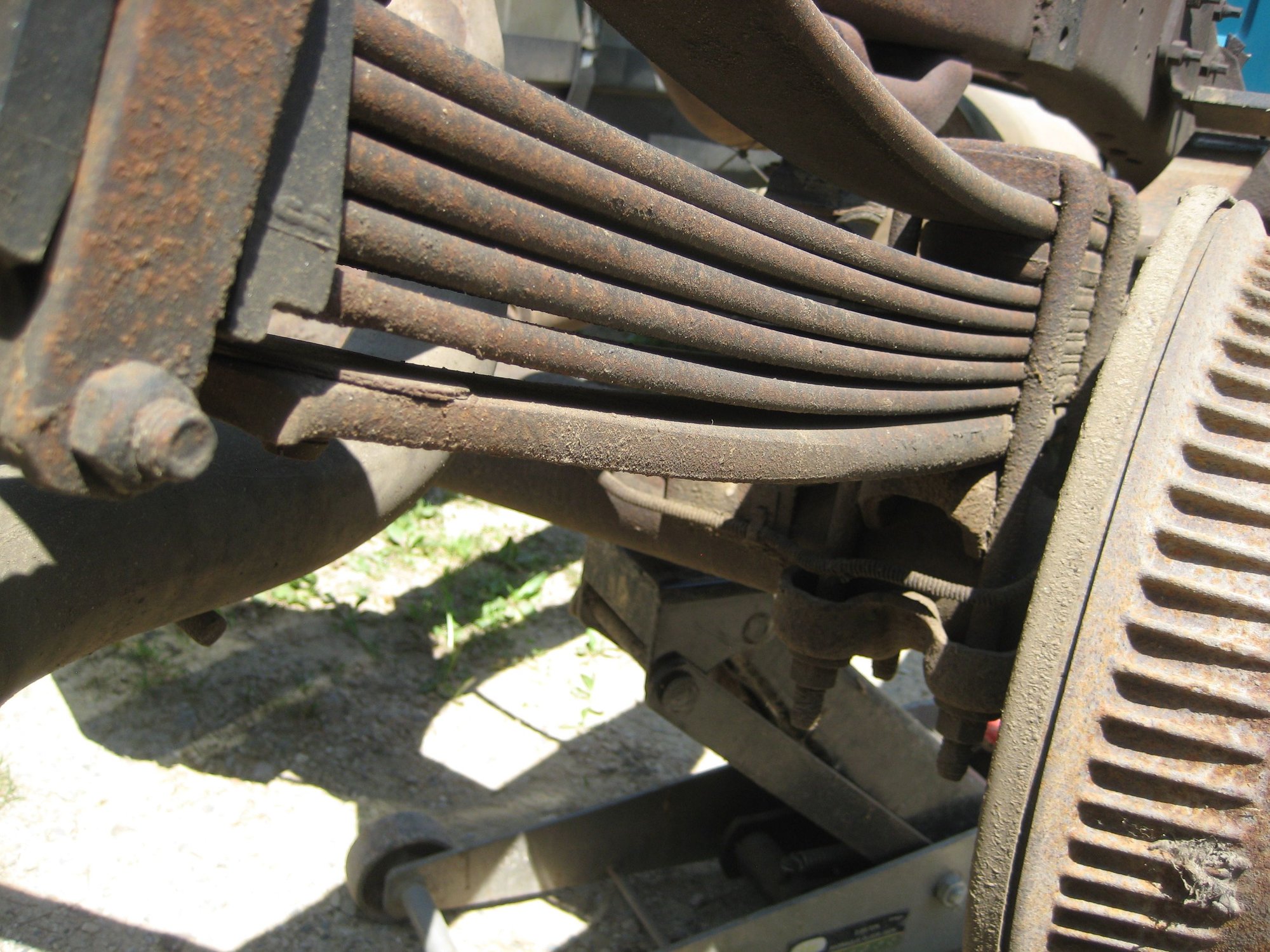

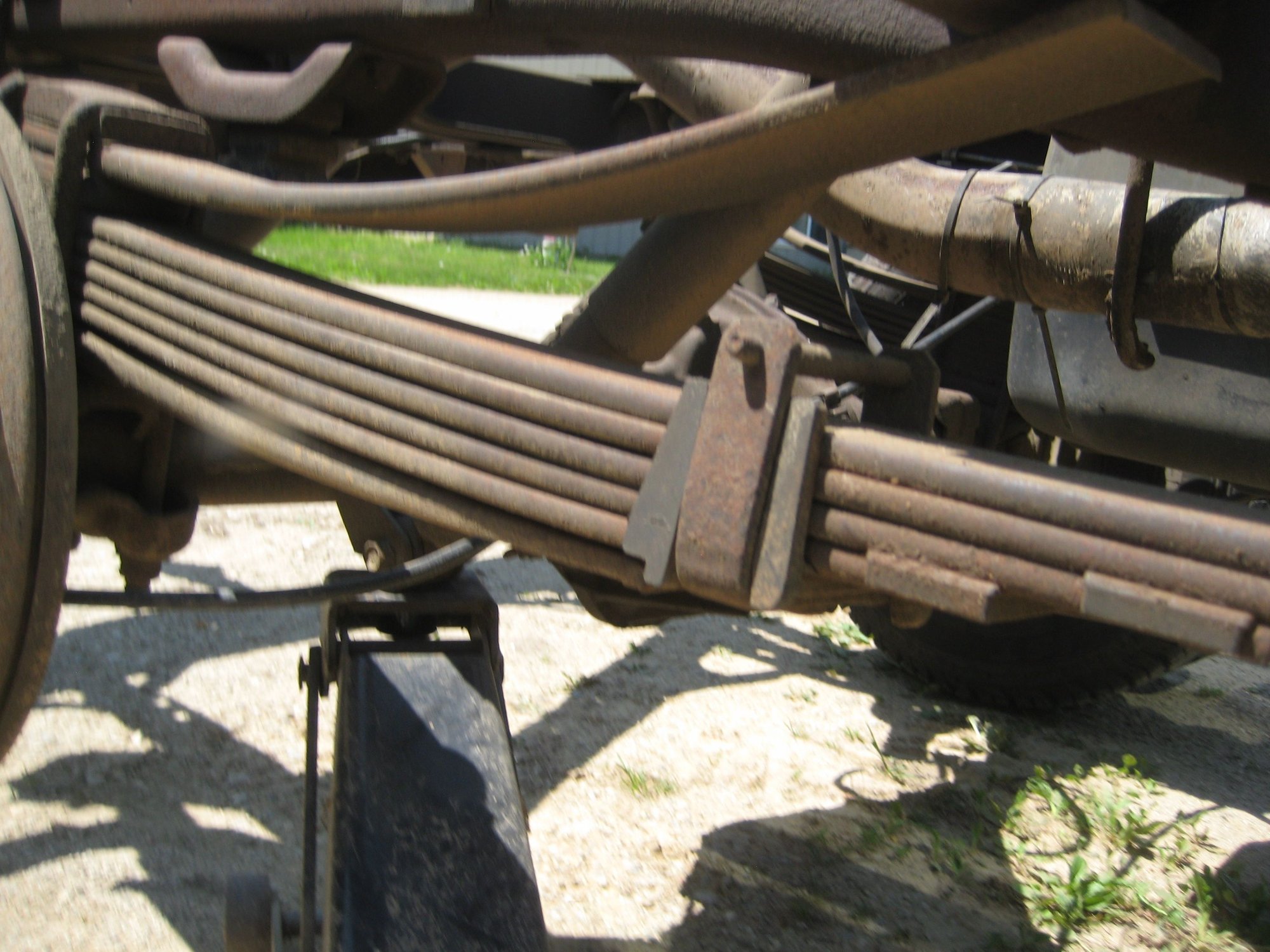

My 1993 C3500 rides, well, "like a truck". It is to be expected, but surprisingly rough when empty.
It is used as a fifth-wheel heavy hauler. But I want to tame the beast when empty. So I have purchased helper air bags with the correct load rating, and want to remove one or more of the leaf springs.
The question is, which ones to remove (or cut short). The top one can stay because it only comes into play as an overload spring (last resort). The bottom one is the thickest and could be removed by leaving a piece of it as a spacer. Others could be the same way.
Here are some pictures.

FYI, I was able to use a cut-off wheel on my grinder and cut the lower leaf spring off within an inch or so of the U-bolts and the bundle of springs. This left the remaining piece as a spacer so that the stack did not need to be disassembled. That alone saved a lot of time, especially because of the locating pin in the base of the bundle and the rear end housing. No need to mess around with something if it is not necessary.
The ride instantly improved by removing the hard bang when hitting bumps in the road. When I install the air ride bags at low pressure and add the new bed to the frame, it should ride very good indeed.
