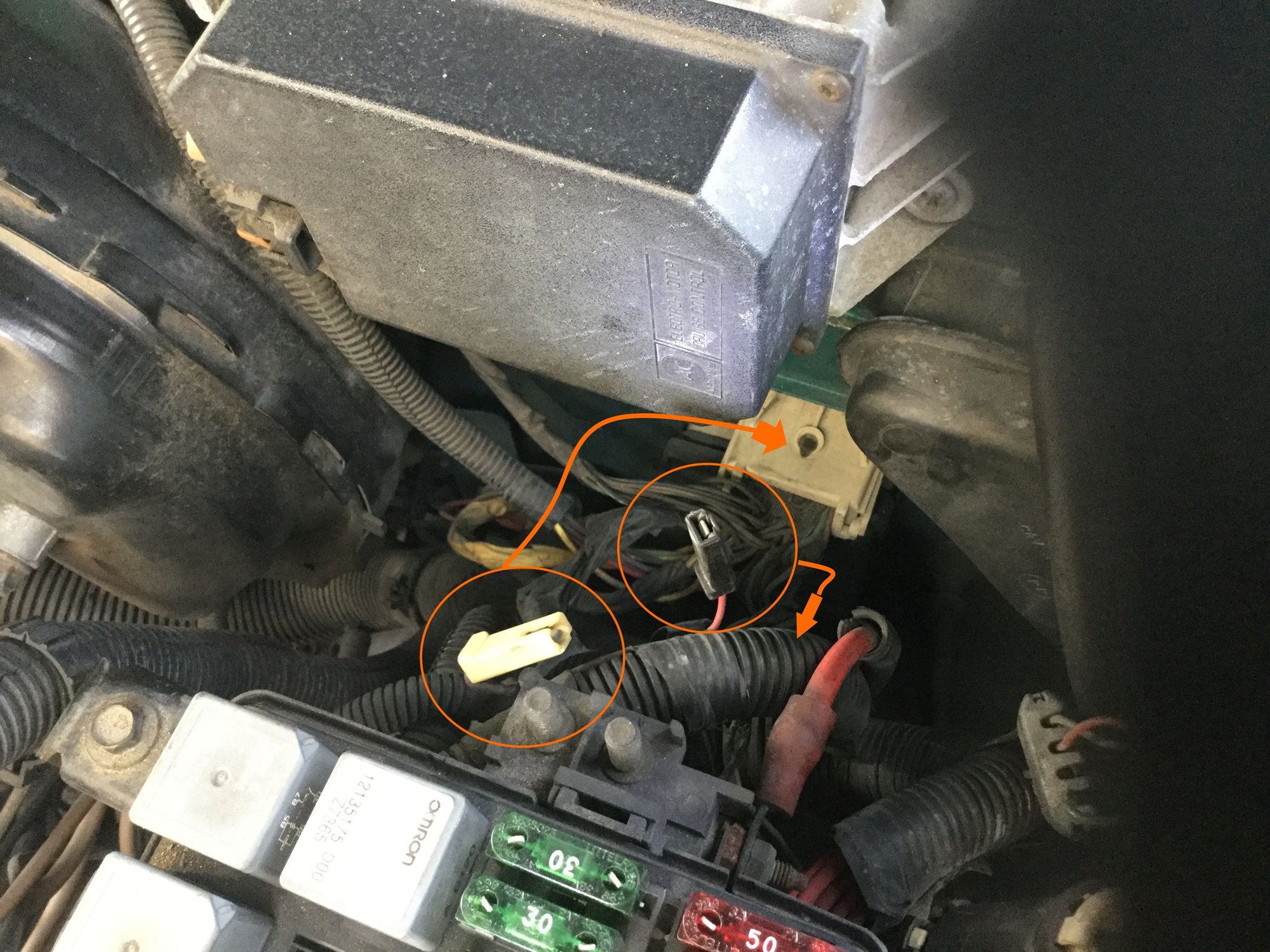

So for a month my truck wouldn't start. And I just replaced my fuel pump relay and its now starting up. But I realized instantly the fuel pump relay is getting super hot to the touch. So I'm poking around and I see these two electrical connectors disconnected from something. It looks like they plug together but they dont fit. The yellow connector is coming out of the yellow plastic wire harness that I have the arrow pointing too. And the black connector is coming out of the main harness bundle that goes into the relay box, I got it pointing to the harness bundle.
So where do these connect? They look like they go together but they dont fit. I'm thinking maybe this is why the relay is getting ultra hot?
And why is the relay getting hot?
Old Nov 12, 2019 | 6:10 PM
Your pump is probably going out, and that is cooking your relays.
I don't think the loose wires are related.

Aside from the new fuel pump relay getting ultra hot instantly when the truck is running, I know if I pull the relay, the truck will die and the back up unit in the oil pressure sensor does not take over. I always thought that was normal that pulling the relay kills the truck lol
Now on a second note of the relay getting ultra hot. My connection 30 is melted a little. This didn't just happen. If I remember correctly this has been like this for years in this truck. We had this problem "fixed" like 10 years ago. BUT I'm thinking, could the contact point not be tight enough and its causing the electricity to arc inside and heat this sucker up? But that would be weird because the truck has been running for 10 years with the connection point like that. So prob not that. Oh well. I'll put in the new oil pressure sensor unit and go from there

And I just removed the relay box and looked under. The connector 30 wire is burnt and bare..... man..... those guys who "fixed" the truck, didnt fix the truck.
So how do I pop out the individual wires out of the back of the box?
