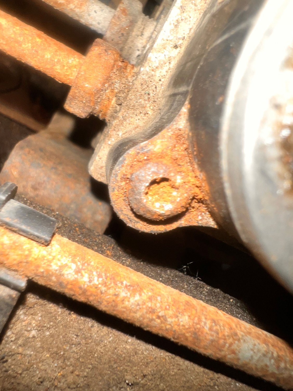

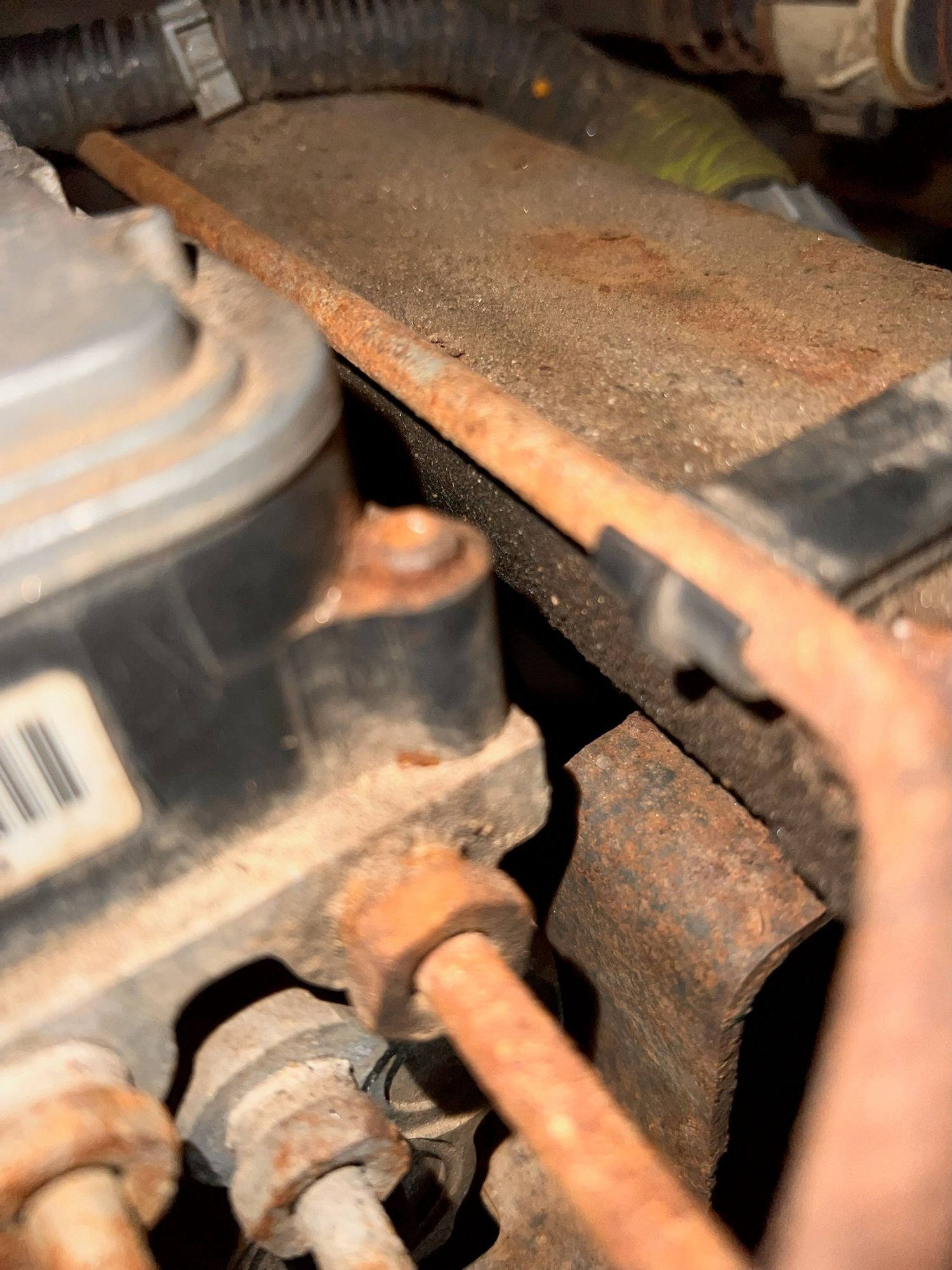

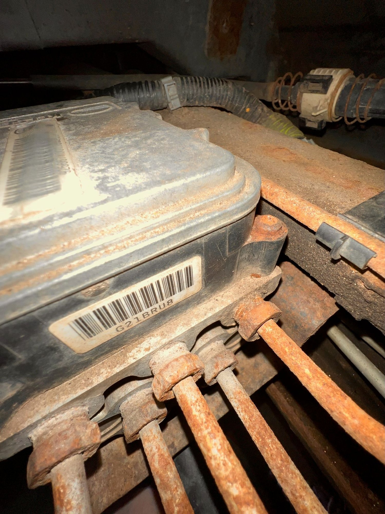

This one the head broke off of
I was having trouble focusing because the phones camera was too close to I dont know if and of these help you or not. That was one of the best torx heads,

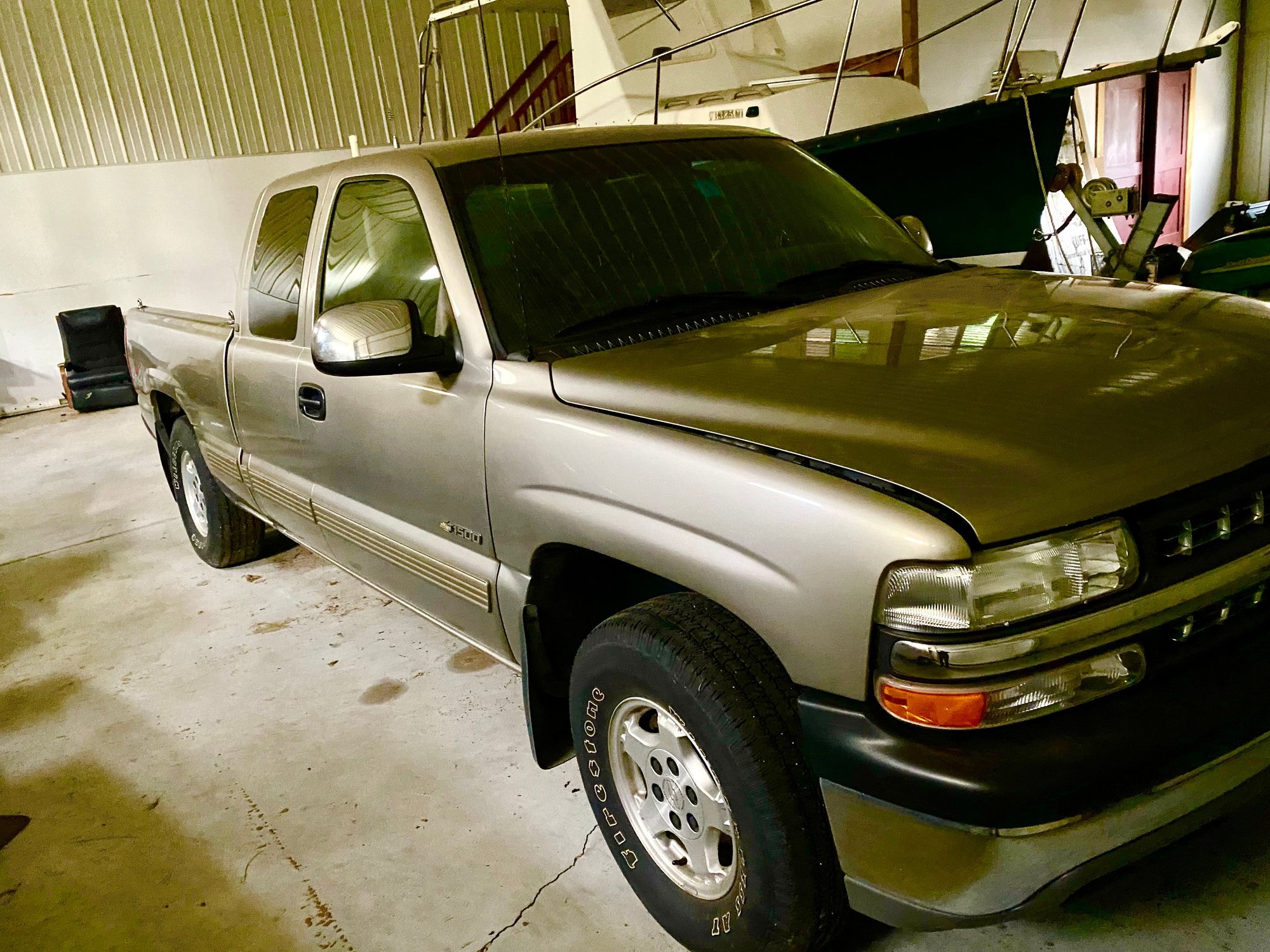

Default Barn find
This is how it sat from sometime in 2015 to 5/2022, non heated, full to the gas cap with ethanol tapioca, that was fun. I think not positive but pretty sure it had the origibal sneakers on it still, fixed that with BFG AT ko2 LR E and coil overs
After a quick cleaning

you could cut a slot in the screw with a small cut off wheel and try to turn it out with a slotted screw driver or impact driver. if that fails cut the head off the screw completely.
Old Jul 1, 2023 | 9:43 AM
chem_man's Avatar
15 Year Member
Joined: May 2010
Posts: 587
Likes: 124
From: Maryland
If you have a Torx bit that fits in the head of the fastener and there is only a little bit of slop, you can add some valve grinding compound to the head of the fastener and then stick the bit in. The grittiness of the valve grinding compound will aid is getting a secure bite on the fastener in order to get it unscrewed,
