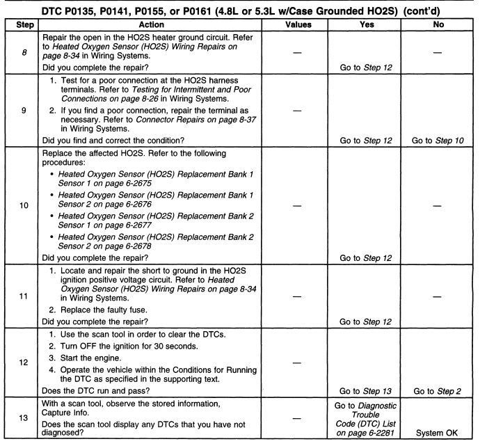

I found a diagnostic procedure you can follow in my FSM. Hopefully this will help.

Could you send me page 8-34 in Wiring Systems?
