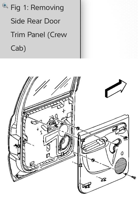

  • Does anyone know of a video of how to remove a rear door panel on the crew cab? Back window won't move up or down though I can hear the motor.

See diagram below for door panel removal (diagram is for the left panel but the right side is the same). There’s 3 screws - lower front corner, one behind the reflector (outside edge should come out with a small screwdriver or panel tool) and one behind a cover in the handle bezel - you’ll see a small reveal to insert a tool and pop the cover off. Once those screws are out, release the snap clips with a panel tool, screwdriver or small prybar (some can be tricky so be cautious that you don’t miss any). After the snap clips are loose, lift up on the panel as there are 2 hooks on the bottom that slide into position.
