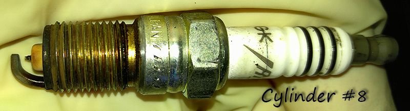

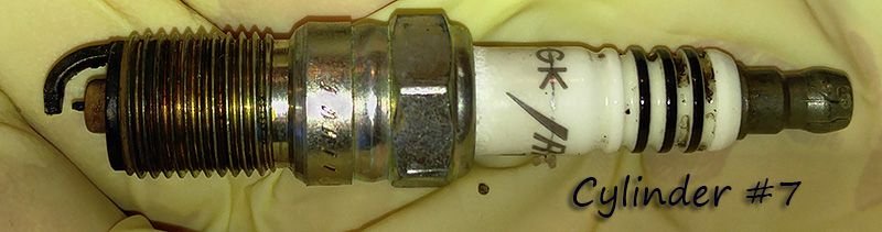

I have never run Iridium plugs before. So I am posting a photo of the plugs straight as I pulled them with no effort to clean them up.
Cylinder #7 Plug has less carbon and looks better
Cylinder #8 Plug has more carbon build up and looks a bit burned
To my eyes while there is some build up of carbon and some darkness they look okay? Why would Cylinder 8 be so much worse than 7 if this were a bad gas problem? Wouldn't other Cylinders also be effected?
