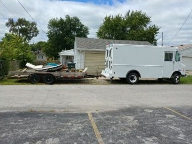

Default p-30 no start
I know I know. Have other problem thread in this section. my p-30 grummin olson with a vortec 350 1998 model. Went to start it last night. Would not start just spin over. I cycled the key the service engine soon light came on it started right up. You could hear the fuel pump cycle. Drove home the warning lamp never did go off and never charged the battery. got home put it in its spot turned it off tried to restart. No fuel pump, service engine soon lamp, but would spin fine. All lights radio worked. Cant get communication from port with my scanner. Its pretty much same as a truck just random relay and fuse box location. Any thoughts. G
oing to pull dog house see if i have pets. Not a daily driver but have my pickup out of service. Down to two motorcycles that run and its raining.

Well found that the fuse panel was not getting power in half of it. Traced it to the ignition switch run wire. Ended up replacing it and the terminal on pink run wire. For some reason the right rear plug wire was on top of the engine. It snapped back on and all is well now.
