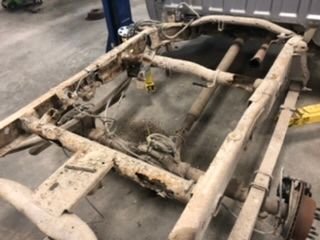

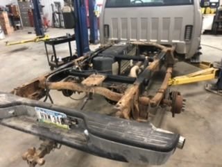

Have you thoroughly inspected the frame to make sure there’s no heavily rusted areas? The crossmembers supporting the fuel tank and spare tire are at the highest risk (I’ll share some pictures later).
I’m an auto mechanic and I live in Iowa so I’m well aware of the frame and suspension issues related to these trucks in the Midwest. If you haven’t thoroughly inspected and/or made plans to repair the frame, don’t put any more money into it until you do.

Good. I’ve only done this repair once. I’d do it again on my own time, but I’ll never figure out why a customer paid to fix this 1999....

Ooof thats horrid lol I bought my truck as a 1 owner from some older couple who bought it new in 2000 and then they bought a newer suburban. it wasnt a bad deal, 130k on motor, nice leather seats for like 2k and a nice paint matched topper, they definitely didnt keep up on maintenance for parts such as tie rod ends and stuff though like it drove good but the parts definitely were bad especially the balljoints after I took it out the balljoints were so loose could move em around barely touching em.
