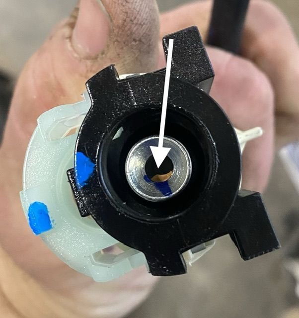

I happened to be replacing the cable on a 2016 Express today so here’s a couple of pictures of the clip.
The tip of the lower cable slides into the sleeve of the upper cable and snaps into the clip. It can’t be removed without pulling the clip out of the sleeve.
When I have made attempts to remove and reuse it, I’ve found that it does let the lower cable “snap” into place as before, but its ability to retain the cable isn’t as strong and it can allow the cable to separate.
