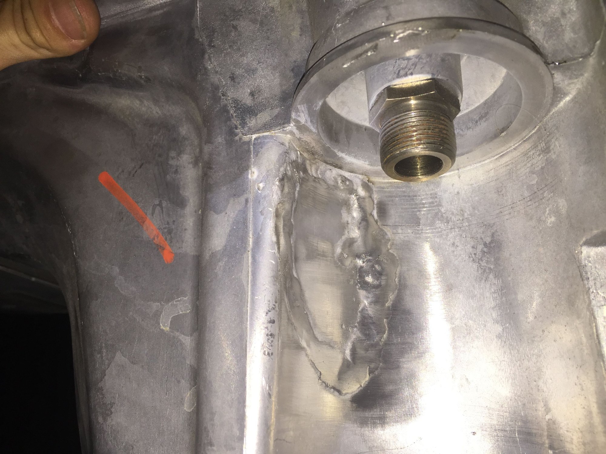

Similar story here, I'm meticulous when it comes to oil changes and maintenance (which is why this is extra frustrating)
I had a slightly different result from the AFM/DOD system malfunctioning...
My 2009 Tahoe with the LC9 engine spun a rod bearing at 109k miles thanks to all the engine oil burning up within 1k miles. Apparently that was just the first thing to seize up but the rest of the engine looked flawless aside from burnt oil residue caking the top end.
Seeing that I was 9k miles out of warranty, I opted to just move forward with repair myself. GM has done a great job of creating tons of hoops to jump through in terms of warranty or recall help on this issue.
I pulled the entire engine apart to find the cause, and ended up just finding gummed up control rings and the one spun bearing as potential causes.
I've since installed a new crank, rod and bearings. I've also deleted the AFM system as I believe this to be a partial cause. Fingers crossed.
It sure would be nice for us to all get a class action going in regards to these engines. No doubt there are thousands of us experiencing similar problems for similar reasons.
Oh, and get this.. The OEM oil pan (which had never been removed since I bought the Tahoe brand new in 2009) had a welded patch behind where the filter threads onto the pan. YES, a ****ing welded patch on a brand new vehicle! How the hell does this happen?? I couldn't imagine
Any ideas as to why this would even be something that someone would repair? These pans are only $130 new.
