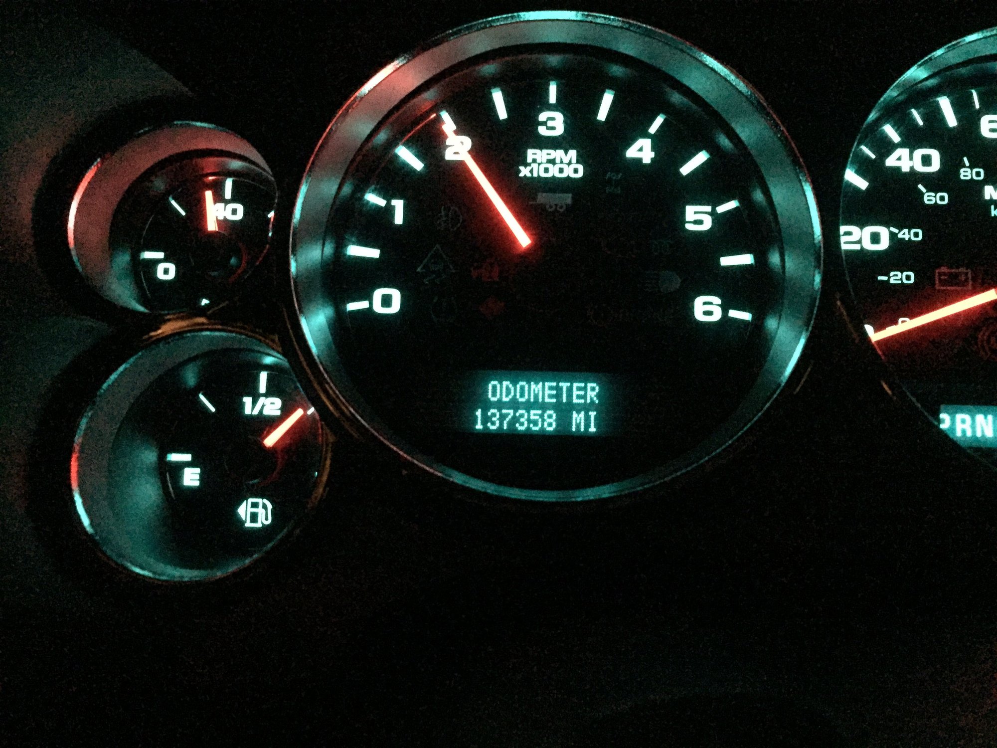

I just bought a 2008 Silverado 1500 that has the 5.3L vortec flex fuel motor with 137,000 miles on it. Four days after buying it I get a CEL. At the same time I noticed oil pressure was around 18-20psi at idle (600-700rpm) with engine warm. Did a scan and it showed P0521, oil pressure sending unit. Cleared the code and it came back less than 24 hours later. So today I got a new sensor and screen to fix it.
I removed the old sensor (which showed no sign of thread lock on it). I fished around trying to remove the old screen forever because apparently they can be tricky to get out. After an hour both my buddy and I agreed there wasn't one in there to replace. Put new screen in and installed new sensor.
Here’s where I have an issue. I looked online and came up with three torque specs for the sensor (11, 15 and 26ft/lbs). Autozone had a guide so I followed it and torqued to 26. I noticed that this put the locking tab about 90 degrees past where it was originally. Is 26ft/lbs too much?
After installing new sensor, readings are about the same. 20-22psi at idle parked in driveway, 35-38 psi at 2000rpm with warm engine. The needle doesn’t bounce around now. Are these pressures ok/normal? It’s been hard to find a definitive answer online as to what normal operating pressures are. The engine has always been quiet since my first test drive. There is no knocking or ticking even when revved to 2000rpm before or after replacing sensor. Oil level is good and is in good shape with 95% oil life left.

Your pressures seem to meet minimums.
Specification (Hot)
  1. 42 kPa (6 psig) minimum, at 1,000 RPM
  2. 125 kPa (18 psig) minimum, at 2,000 RPM
  3. 166 kPa (24 psig) minimum, at 4,000 RPM
The layman rule of thumb is 10psi per 1000 RPM.
The pressure relief valve should start kicking in around 60 psi, so your pressure seem "safe".

The New part had some red stuff on threads. I was assuming it was thread lock. So if I torqued to 26ft pounds what should I do now? Any advice would be greatly appreciated.
BTW truck started fine this morning but pressure 35. Outside temp 40 degrees. Stayed right around 30psi on my 10 mile commute (1800 rpm @60mph). Was back down to 20 or just under when I parked it.
Im just worried I might have bought a truck with a bad pump or o-ring. I don’t have the money to have that fixed.
Old Mar 18, 2020 | 3:47 PM
It's in there now. Just leave it.
If your pump/oring was bad, then pressure would be too low.
Just keep an eye on it, but I think you're fine. Happy driving.

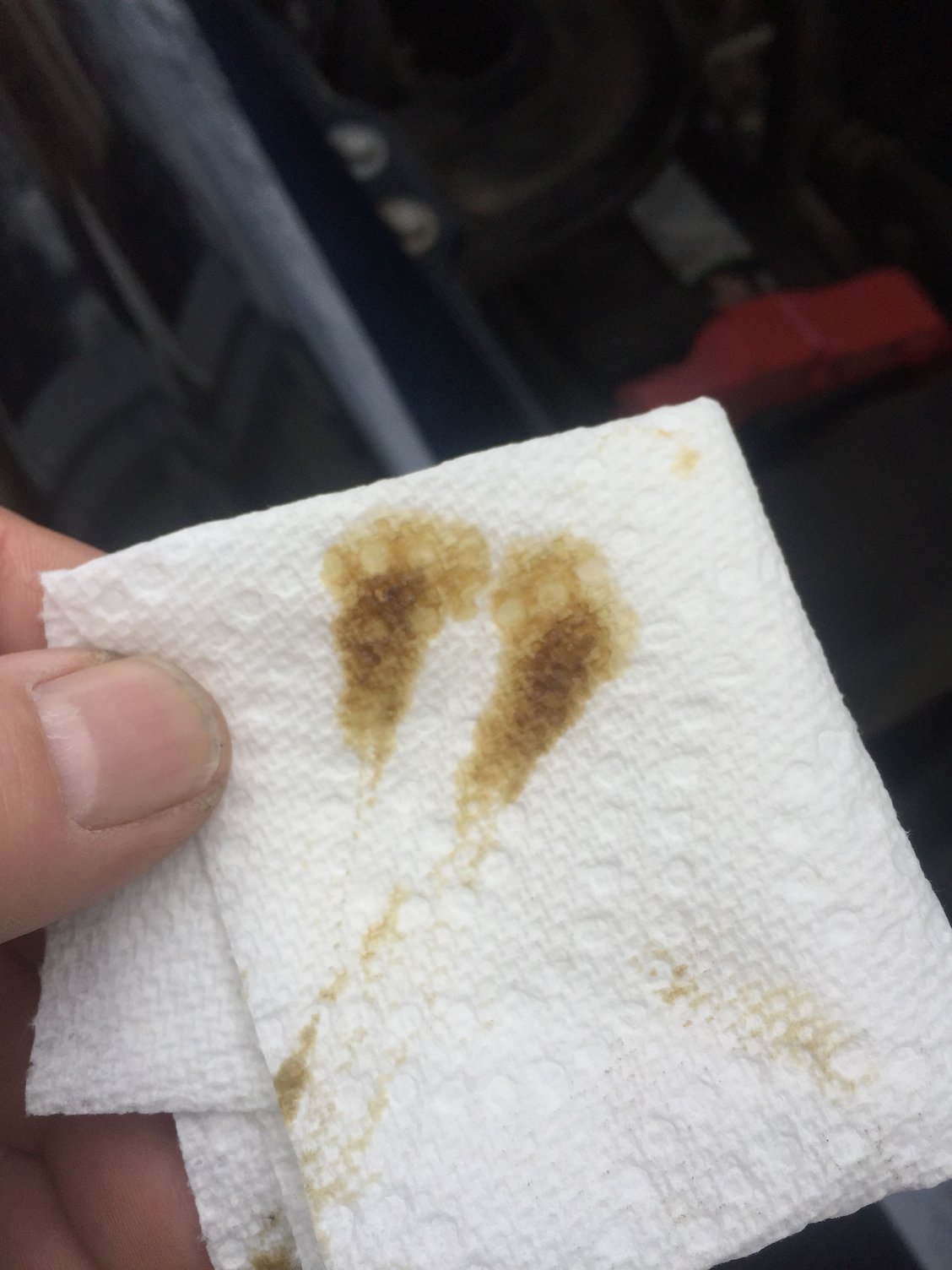

I checked the oil level totally cold today and it was a bit low. Looked in great shape though. Added 1/2qt of 5w30 castrol edge full synthetic because that’s what I run in all my GM vehicles. Next oil change it will also get a Fram untra guard filter.
