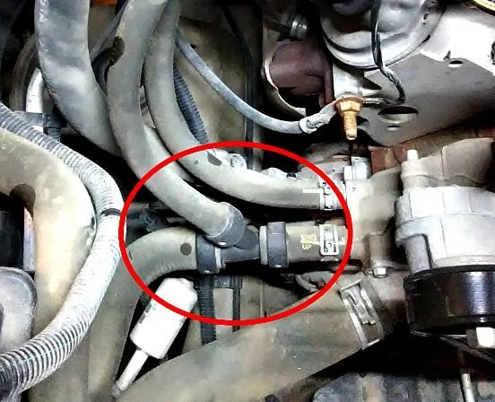

My heater hoses are definitely not generic. It's like an assembly of hoses coming together.
I wasn't to jerry rig it, but may have to if I can't find and OE style replacement
Here's a pic of the the section I'm speaking of...

Well, if you want, you can get ac delco/gm hoses. Here's a list below of part numbers for the various hoses. But you can also get 3rd party hoses for a lot less. Just check at autozone, oreilly, etc. or amazon
ACDelco Hose 30124
ACDelco Hose 18221L
ACDelco Hose 18206L
ACDelco Hose 34000
ACDelco Hose 22884219
ACDelco Lower Radiator Hose 15-34717

I can also use the AC Delco number to cross reference and get part numbers of other brands.
