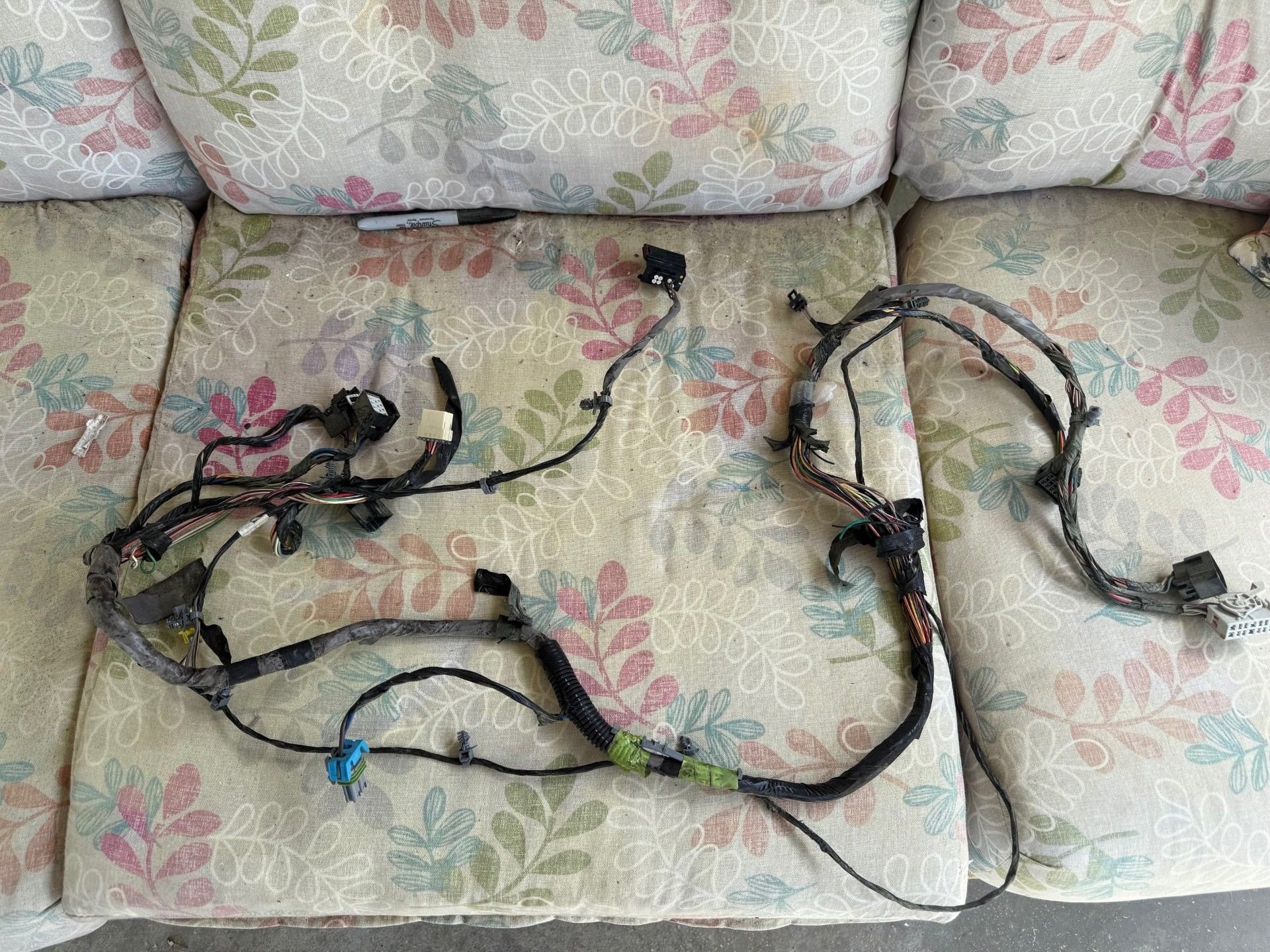

I have a 2009 Silverado 1500 and I am not able to find a replacement driver side door wiring harness bundle. Several of the wires inside the door were broken and one of the connectors was broken. I was just going to buy a new wiring bundle but cannot find the correct one. I went to the Chevy dealership and they said there were 3 but 2 had been discontinued. All the ones I see online are not the right ones. In the picture of mine, the far right end goes from the door to under the dash and into the fuse box in the dash and under the floorboard to go to the passenger side. The bundle of wires not covered is where it goes from the door to the dash. Are these available anywhere??

This might be an ID tag with the GM part# on it - you can at least use that to confirm possible matches.
If you’re unable to source a replacement, the section of wiring that runs door to cab can be repaired by splicing the wires on both sides, that way you have one piece of wire in the flex section instead of the splices.

Maybe a wrecking yard fiind?
