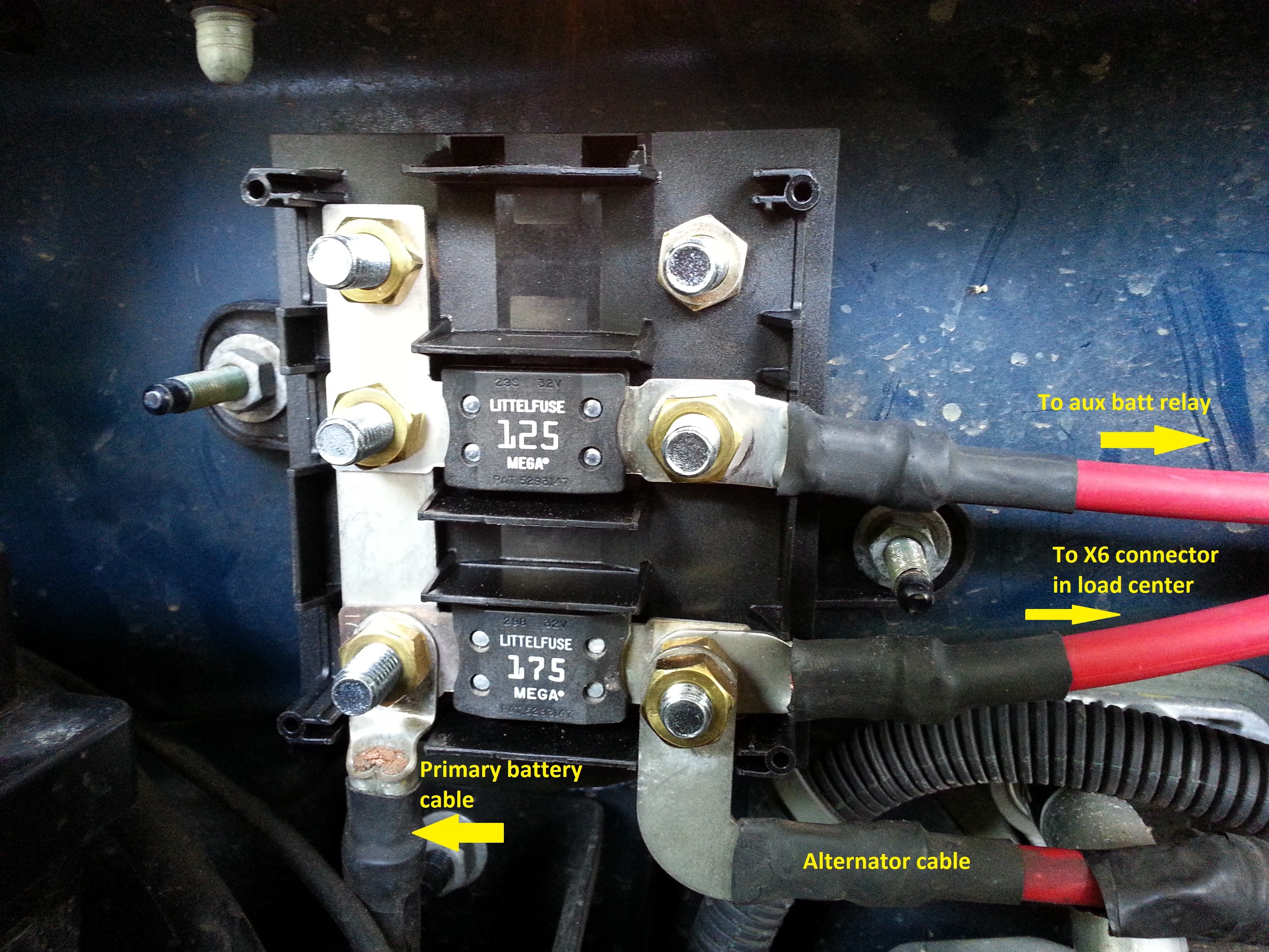

Check the megafuses on the firewall, on the passenger side. IIRC, you'd have a 125-amp and a 175-amp in there. I'd wager that one of them got fried. They cost like $8 at an auto parts store.
Here's the location, circled in yellow. The cover just pulls off:
Once you've pulled the cover off, you'll see this:
If these are both intact, then it's likely that something got fried, like the powertrain control module, or the body computer.
