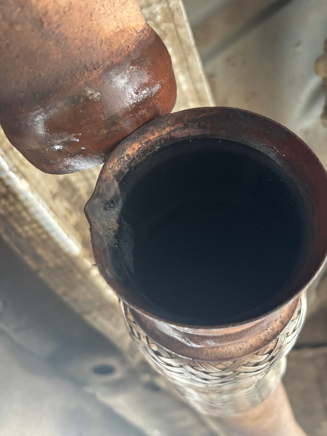

Hello,how would I go about fixing this issue,the band clamp on the joint inbetween the flex pipe and cat seems to be leaking especially from where the bolt goes in and clamps down around the pipe. It seems to be pinching the pipe causing the leak. And I can smell it in the cab when I start it in the morning…

Yeah,unfortunately I have no warranty,but I did manage to reshape to a point where it mostly seals up good now.

Can get a new clamp and reposition it 180 Deg. I've had good success
