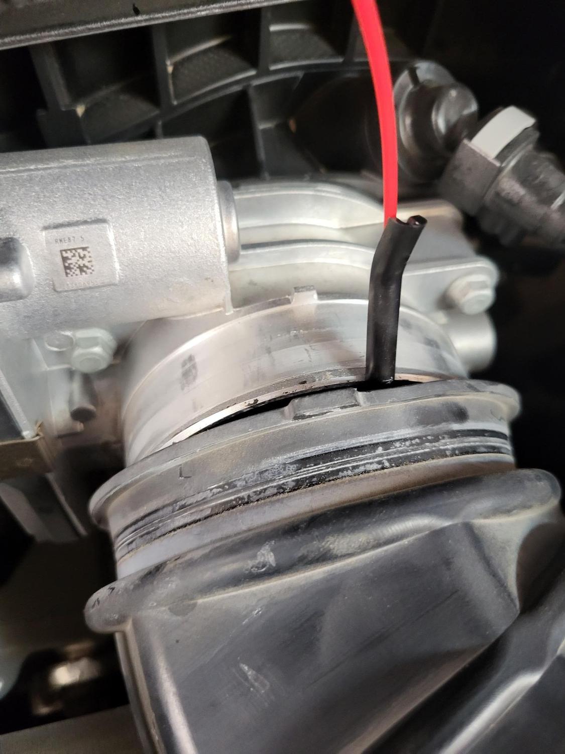

So, that brings me to the reason I started this thread. Did my first Seafoam "treatment", but I want to do more. Anybody done a catch-can? I'm gonna do it, made up my mind, so I'm looking for the best, cleanest, neatest, most effective way to do it. Get a "kit"? Which one? Suggestions? Oh, and Seafoam pics below FYI.....
