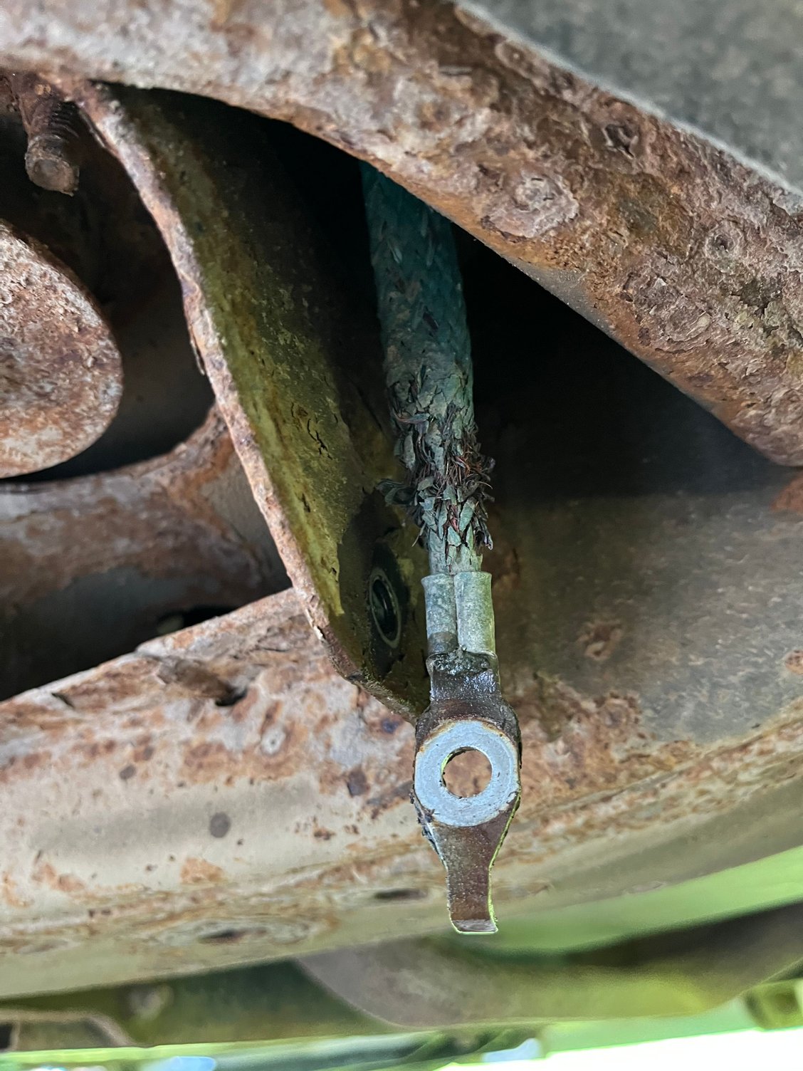

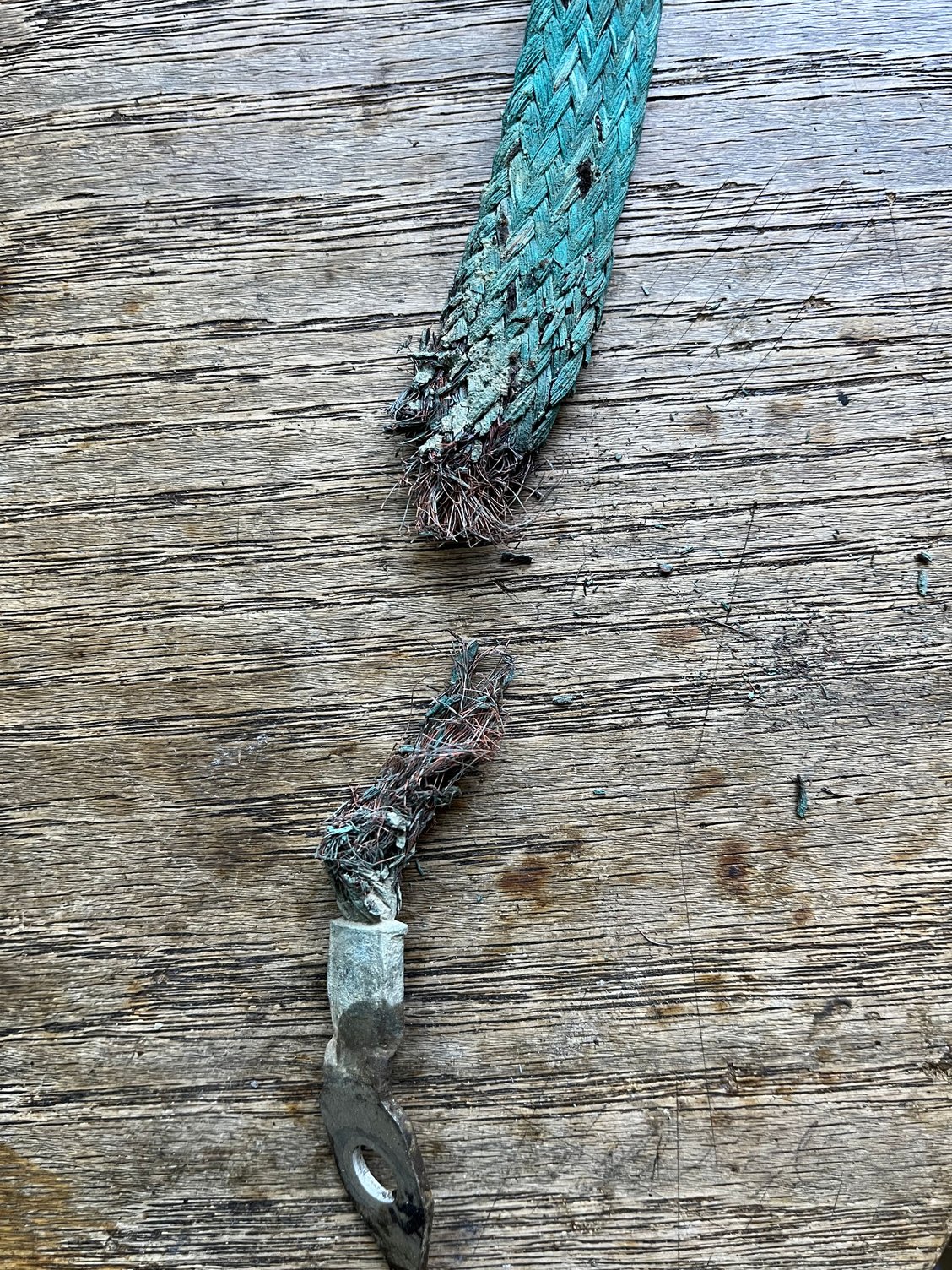

There is a body to frame ground that is exposed to the elements. And I live in a northern state which uses salt in the winter time. This braided ground strap was completely dissolved on my 2019 Silverado causing loss of electric steering and it also tossed a code for brake controller. I replaced the strap with a shielded wire. Hopefully this won’t happen again there was only 43,000 miles on this vehicle.
Attachment to the frame just behind the right passenger tire
Was so crumbly it broke into as I removed it

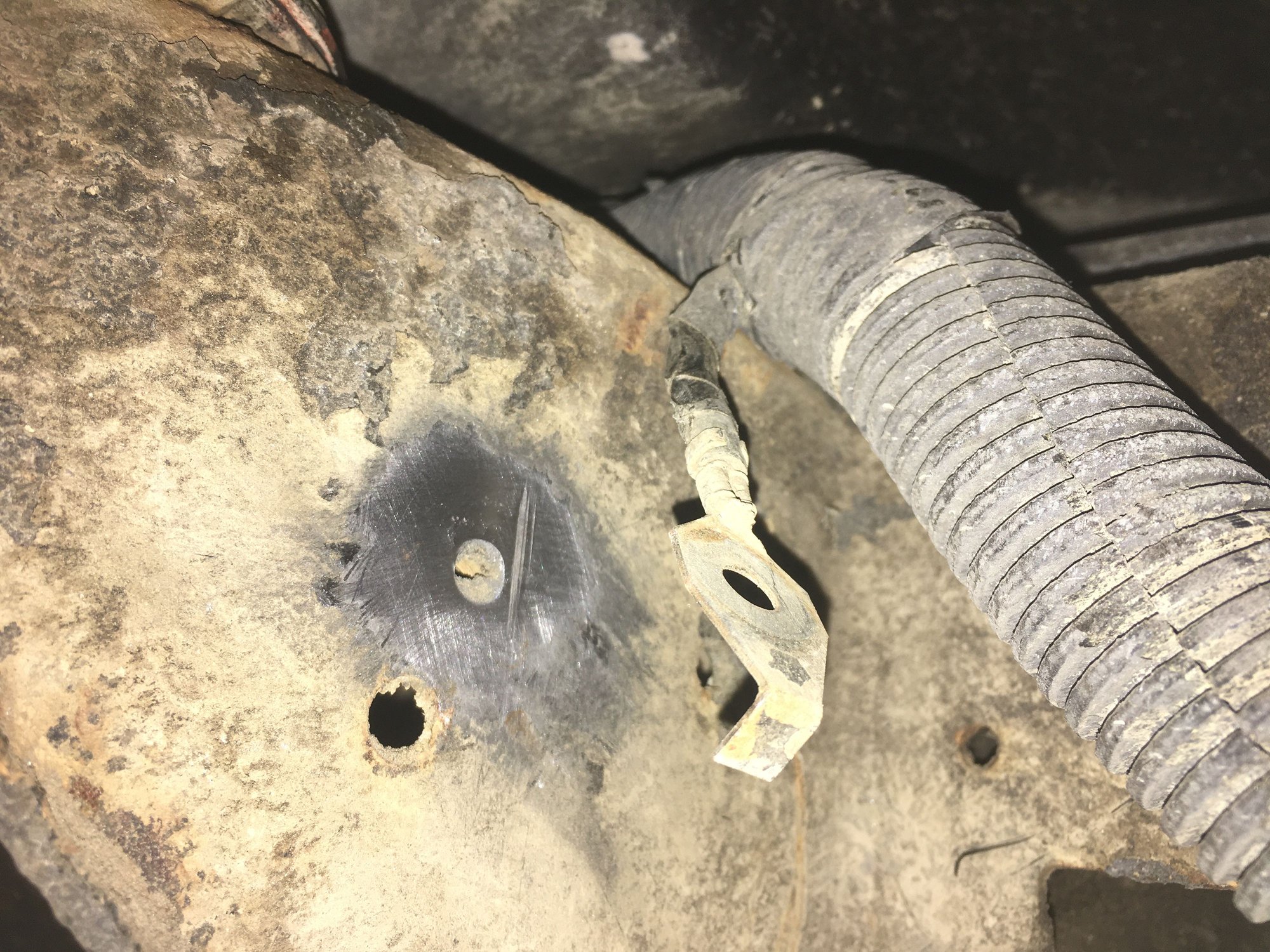

Old Sep 2, 2023 | 7:04 PM
yeah that's some shoddy design. At least mine has insulation on it.
