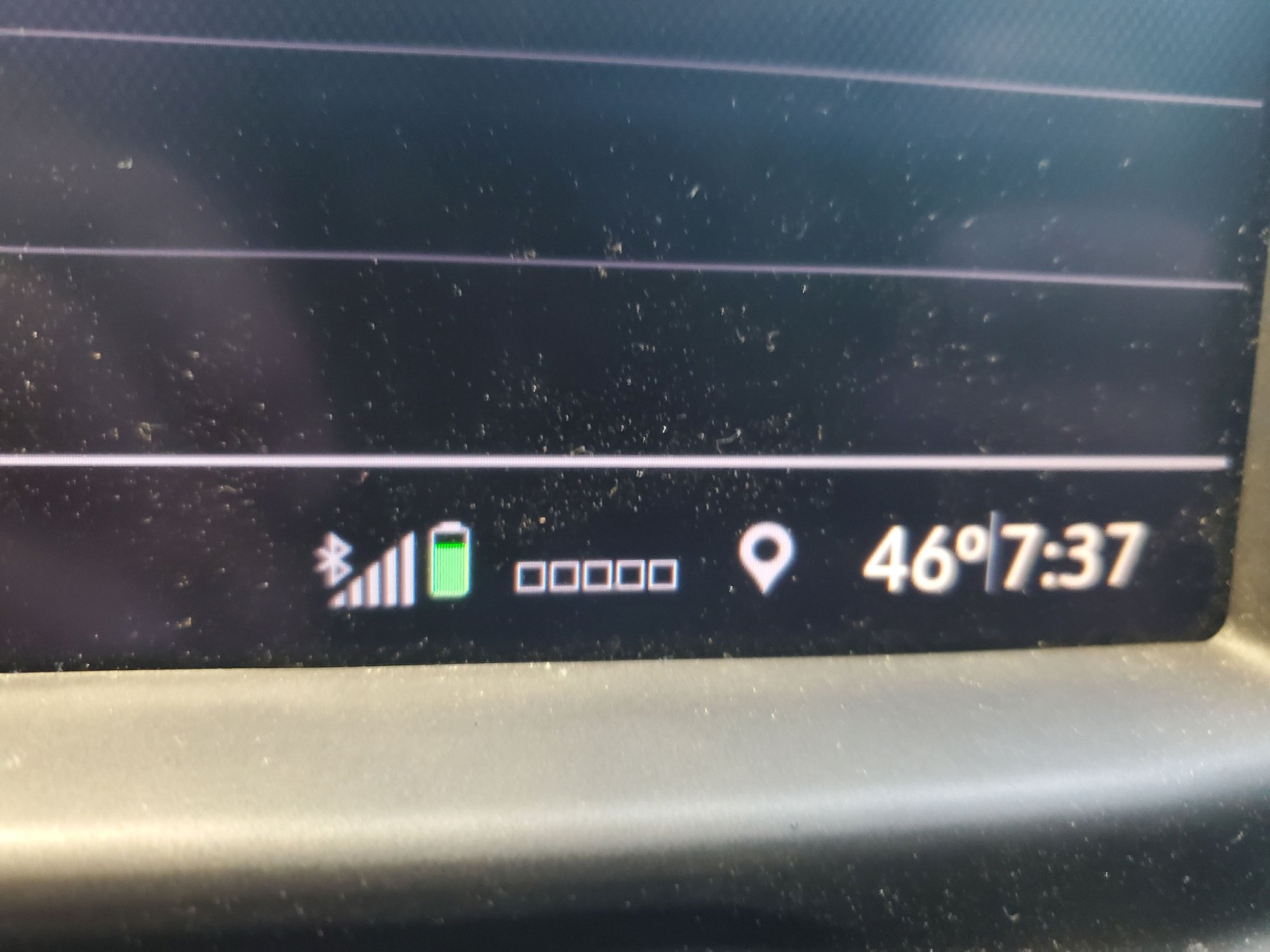

Copy that did exactly what you asked and "Updates" is not shadowed unless I am in drive. However when I hit the button I get the following. (See pic)
Failed network connection, the only way to get it to run an update is to either Hot Spot my phone or connect to my house Wi-Fi.
Additionally I would ask you what do you see on your screen here (see pic)
Those 5 little empty squares in between the battery and the little arrow? My understanding is that this is the reception or cell cervice bars of the vehicle.

OK, thanks for humoring me. Dealership time.
As far as the icons, those a completely different that the ones I see on my infotainment center display. I suggest you check your owners manual.
What I see is Pat (my name) and a Battery Icon with a rough indication of the charge in my cell phone and then the Temperature and Time numbers. Also mine are at the top of the screen.
