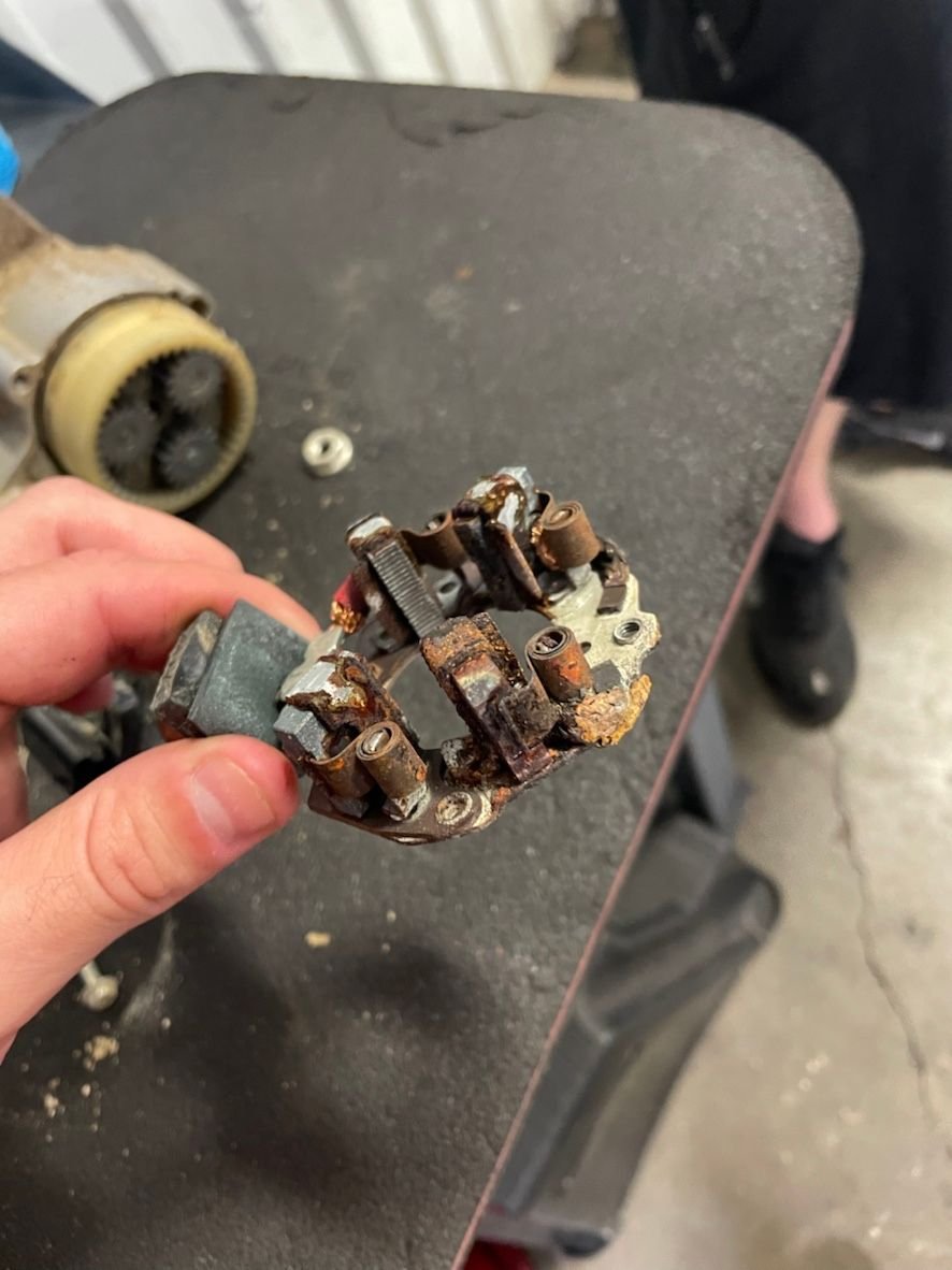

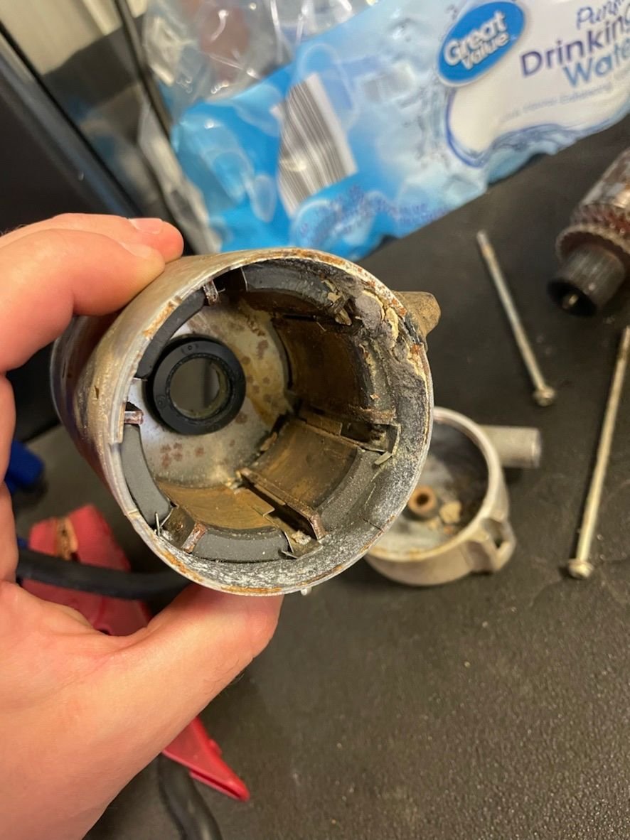

Truck failed to start after sitting for the July 4th weekend a few days. Had it towed to the dealership. Finally got to it today after sitting for a week.
Diagnosis is “customer abuse - water in the starter caused the failure”. They will not cover under warranty.
Truck is used in Georgia and on the farm. About 2 weeks prior to this we had some heavy rains and went through a muddy spot in a dirt road that I needed 4WD to pull through. It hasn’t been in a lake and it hasn’t been out in the swamp.
Are starters so delicate these days that you can’t use a truck in 4WD for fear of damaging the starter? I’ve done far worse in other trucks. This is a brand new truck and was not “abused”.

the damage/corrosion seen in your pics has been going on alot longer than 2 weeks IMO. Suggests longer term/repeated water damage to me. Boat starters do the same thing when a bilge gets too wet. It's a component that's not happy in the water. Too bad it's not engineered to be higher up off the ground.
Agreed. Looks like lots of corrosion on that starter. Cant' say as I blame the Chevrolet dealership for not wanting to repair it. It might be possible to install a shield of some kind to keep the worst of it out, but that would reduce any cooling effect.
Had one moron with a 4x4 use RTV sealer on his starter. All that did was keep dirt and water in; needless to say, it failed completely.
Same exact thought...had to reread OP thinking vehicle might have been used and suffered flood damage..
