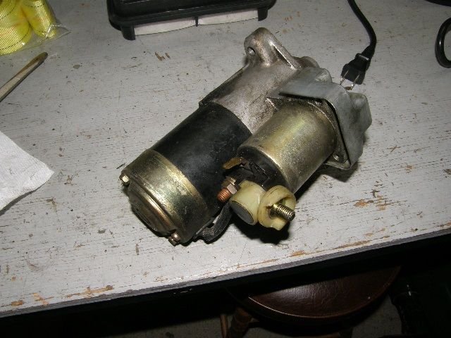

In the V6 Tracker, the Chevy service manual wants you to remove the exhaust crossover pipe,
the front drive shaft and drop the starter motor out the bottom of the car. That's a lot of disassembly.
I can attest it's possible to wiggle the starter out through the top without all that disassembly.
The flywheel is clearly visible once the starter is removed.

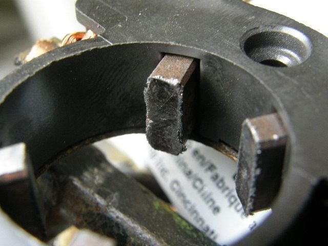

I pulled the starter because I suspected the solenoid was no longer extending the pinion gear
into the flywheel. The starter motor was spinning but the engine was not cranking.
I had it tested at a reputable starter shop in town. They verified the solenoid was bad.
They replaced the solenoid and installed a new set of brushes.
This is a diagram of the starter circuit.
I cut the old solenoid open to see how it was actually built.
These are the parts I found inside. Now a word of warning. A bad solenoid is not the only thing that can cause the starter
motor to spin without cranking the engine. A weak battery will exhibit the same symptoms. So connect a booster battery
before you remove the starter.
