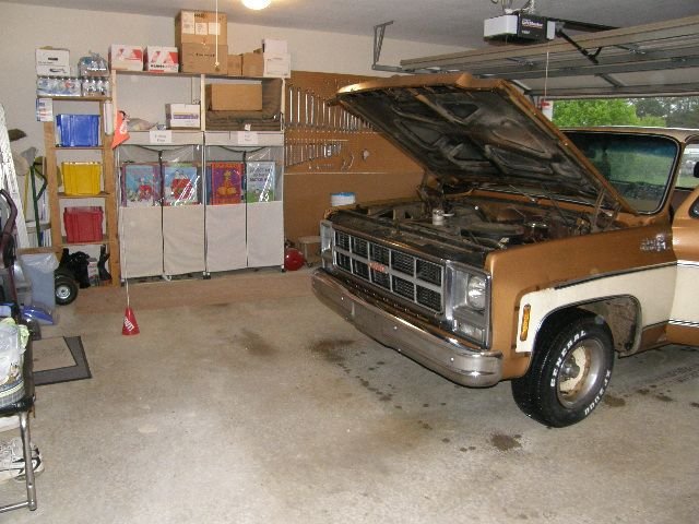

My other vehicle is a 1980 GMC with a 350 and a Rochester quadrajet 4-barrel carburetor.

Now thats a truck worth busting knucles under the hood. My buddy had a 78 or 79 back in high school, his was all black with brown interior and had a 5 speed tranny in it, that truck was fun...he ended up trading it off for a badass Chrysler Cordoba, from the Ricardo Montálban commercials lol, not gonna lie though thay car was effing sick af with a 360 small block in it, that car would roast some rubber! I haven't seen another one of those since back then, would be sweet to have one of them they were slick designed.
