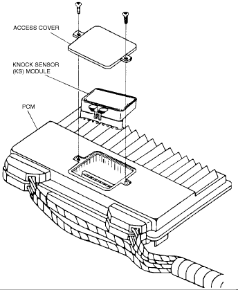

Iam trying too find the Electronic Spark Control Module Sensor,
on my 1994 Chevrolet Camaro 5.7L, someone told me that it was on the Distributor and I didnt find nothing on the Distributor,
I dont know where its located, can someone please tell where that sensor is located?
I would really apreciate it
Old Aug 3, 2010 | 10:06 AM
rkuelbs's Avatar
Joined: Aug 2010
Posts: 22
From: Dallas, TX
Also known as the Knock Sensor Module, the ESC Module is located inside the PCM. By the way, the PCM is located in the Right Rear corner of the engine compartment.
Attached Thumbnails Can someone help me find a Sensor on my 1994 Camaro 5.7L-escmodule.gif   Can someone help me find a Sensor on my 1994 Camaro 5.7L-escmodule_removal.gif
