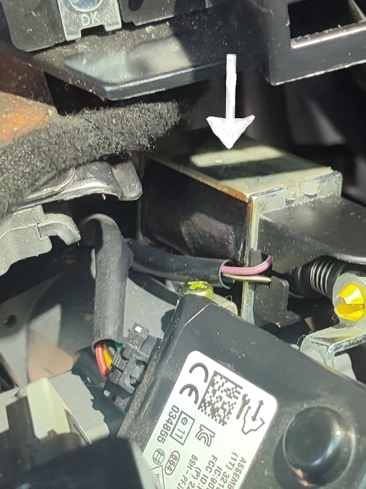

Hi there, Rednucleus! Thanks for the quick response! And I hold the smoke in as long as possible! Actually, I did take off the covering over the steering column. No wires appear melted. BUT when I started the car, sure as anything the smell returned. And to my surprise, it's a little square thingy that's attached to the ignition switch housing that is BOILING hot. I will attach a pic. Now that I know, I'm TRYING to order a new ignition switch (which is nearly impossible due to the UAW strike).
Thank you again for getting back so fast and I hope this helps someone else down the road!
This is the smelly bugger! It's attached to the steering column.

So, the white arrow in the above image is pointing to a "shift interlock solenoid" (GM 95931073) and it attaches with 2 phillips screws onto the ignition housing. It's duty cycle starts when: you turn the key on, then apply the brake and finally, the transmission is shifted into gear. The longer the vehicle idles in Park, or even sits with the key on, the hotter it will get. However, it should NOT get so hot as to start smoking and stinking! Since the solenoid seems to be more available (and cheaper!) than the entire ignition housing, I'm gonna try replacing it first. FWIW, I'll document my progress until complete. Thank you.

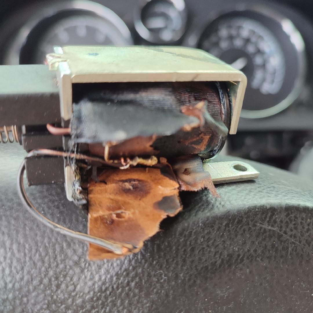

Well, Red, guess it's just you an' me looking at these posts, huh? Mebbe not even you!! Anyway, on the off-chance that someone might benefit from my experience, I replaced the shift interlock solenoid (Amazon-$21.90 [OEM!]). Needed two new shear bolts (22722469) as well to allow for the ignition housing to clamp onto the steering column. This was what the OLD part looked like:
Hence, the stink.
Unfortunately, the new part is getting hot as well, albeit not as fast as the old one. We can idle in park for about 10 minutes before it gets hot, as opposed to 3 minutes. Will have to continue the work-around until something else pops into mind....sad.
